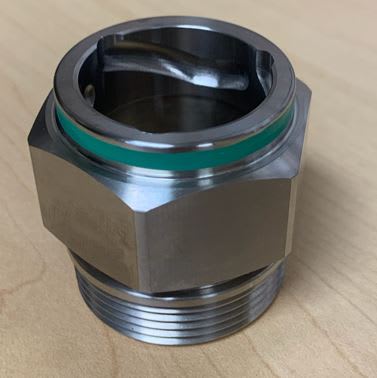

Hi All,
Looking for an automated machine that can paint a stripe on a 2” diameter pipe x 3” long via rotation 360 degrees.
Preferably automated so it can be loaded via a 3 jaw chuck and press a button while worker builds the next assembly.

So does that nut move up past the green stripe like a stub flange?
Is the painting before or after that hex nut is finally added into the connector.
How about an elastic flat band which you just slip over the stub end?
Here it is for anyone interested.
How many of these items do you need to paint? Is this a one time batch or something that will be in continuous production?

Not exactly, your paint needs to be something special.
Quick drying, meets EHS rules, and doesn't contain anything that can harm SS.
Such as this from RDT F7-3T (this doc is ancient but still commonly used). Unless of course you have a better spec to use.

The hex nut is one machined as shown. We make them by the hundreds, looking to color code them by month for tracking purposes.
They cannot be dipped into a paint due to the internal grooves shown would be affected.
Production preferences are for the stripe to be applied while the worker performs another task so some automated process is preferred. Quick drying dye or paint also preferable.

Seven different colors one for each year repeats every eighth year. Used to indicate age of hex for a two year rebuild program.
Must be visible at a distance using a flash light.

rb1957, need a visual indication that can be seen at any position the nut gets tightened to so a dot is out. Need to ID year only once installed on the apparatus so marking the bags or boxes won’t work

The problem with inkjet units is that they must use thin inks, usually with MEK or acetone as the solvent.
A simple dot spray (Carco) or a roll marking system lets you use heavier paint like inks.
Or you could use a permanent roll marking with dies.
Though one of these with a solid roller in it narrow enough for your slot would do the job.
In any case you will need to fixture and rotate the parts for marking.
