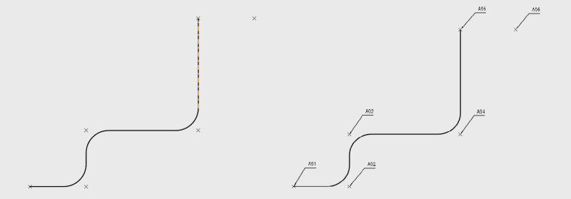

Here is the working version of what the previous thread managed to achieve. Still a long shot from what I am looking for but someone may find it useful.
I will clarify in my next post what exactly these guys were trying to do, and see if anyone can collaborate with me by picking up where these guys left off to get this macro working.
Code:
' Purpose: Code to create a text file in Folder (MUST BE SPECIFIED BELOW) and write CATDrawing points coordinates inside from the currently active view
' Usage: 1 - A CATDrawing document must be active and drawn points must be present (CATPart points don't work)
' 2 - Run macro
' Author: modifed by ferdo, originator unknown (Disclaimer: You use this code at your own risk)
