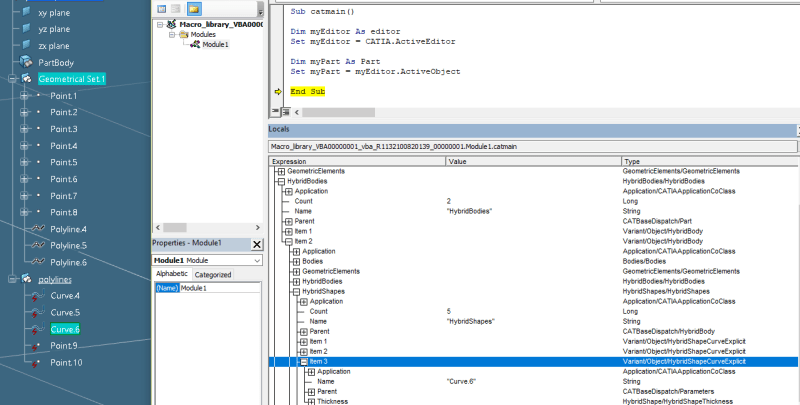

try to use VBA as it will let you "see" or Watch object in debug mode, (see here)
So we will find the geoset/HybridBody using it's name and get wireframes/HybridShapes inside it, if the wireframe/HybridShape is a polyline, we do the fill, else we take next shape.
Try to do something like that and post your progress, we'll follow.

if you want to see the object structure of your CATIA part I suggest you use VBA and the watch object like in the link i gave you.
That and the V5Automation.chm file from your catia install will help you progress with CATIA object understanding.
From what I see in your code, your polylines are actually isolated curves, and not CATIA V5 native polylines, that's why your code is getting the polyline from Part.Parameters
So I suggest you either get all parameters one after the other and if name is "polyline something" then you make the fill, or you do a search in Part.Parameters but as you said you have 20k polylines I would go with the first option (I had bad memories with big search in catia, it used slows the process, not sure working with 20k search is OK now)
I see in 3DX19X that explicit curves are now available from hybridbodies:
so if you go like this:
Code:
Set parameters1 = part1.Parameters
for i = 1 to part1.Parameters.count
     Set hybridShapeCurveExplicit1 = parameters1.Item(i)
     myParamName = hybridShapeCurveExplicit1.Name
     if xxxx
        you do the fill here
     end if
next i
