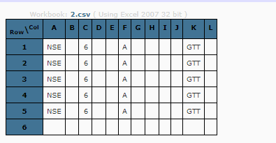

I am trying to make a macro but i met with a problem so i am looking for help
So plz have a look and help me out

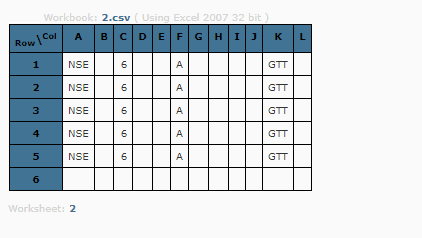

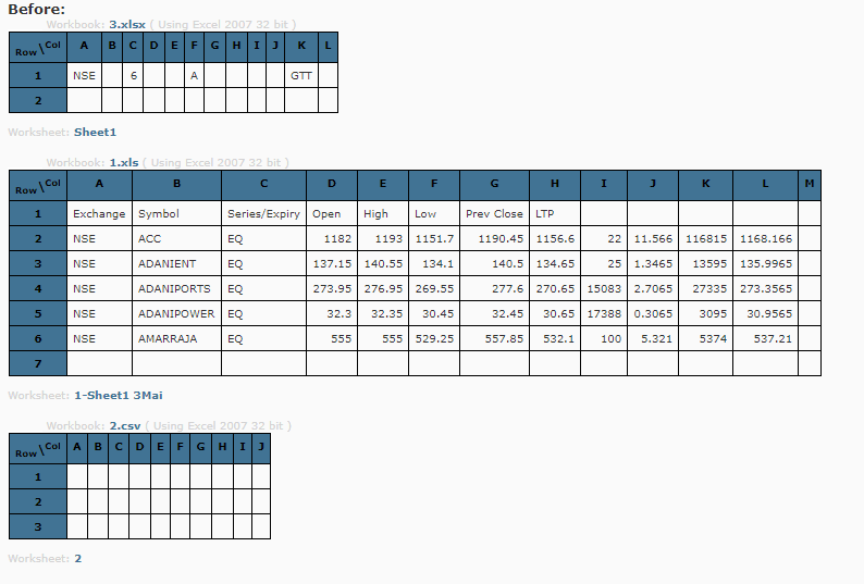

Sure Sir all details are give below
1.xls first row has headers so dont count that
In 1.xls count the total number of rows that has data and copy the 3.xlsx sheet3 first row(first complete row copy) and paste that much time of 3.xlsx first row of sheet3 to 2.csv
suppose 1.xls has data in 5 rows then copy 3.xlsx first row of sheet3 and paste it to 2.csv 5 times
i have attached a sample pic plz have a look
sample1.xls is 1.xls
sample2.csv is 2.csv
sample3.xlsx is 3.xlsx

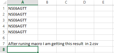

Instead of that i am geeting this after runing macro
See code below with comments.
Should be enough to get you going.

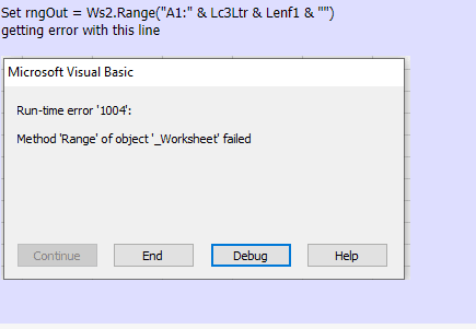

Set rngOut = Ws2.Range("A1:" & Lc3Ltr & Lenf1 & "")
getting error with this line
Sir if my macro contains many errors so plz make a new macro i am getting error i shared u al details
I am not a professional one
You didn't share details, you posted a screenshot of an error message. You haven't answered half the questions I have asked.
But the code I posted is a new macro anyway. Did you try running it?

vba will be placed in a seperate file macro.xlsm
i have three files 1.xls & 2.csv & 3.xlsx
In 1.xls first row has headers so dont count that
all files are located in a different path
sheet name can be anything
plz see the sample file

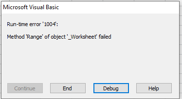

Yes i ran the macro Dis Sir & i mentioned the error details to u also
You didn't say which macro you were running when you got the error.
Did you create two new worksheets for file sample1?
What were the values of Lc3Ltr and Lenf1 when you got the error message?

I just googled and i saw the macro similar to this i modifed little things so thas y i am unable to provide u the exact details of my macro
and i ran ur macro Dis Sir which u modified and provided to me
You need to read and understand the comments I added to your code.
To avoid the complications of using three files I created two new sheets, but if you are using your original file with just one sheet it won't work when it tries to write to sheet 2.
But if you don't understand what is going on with the original code I really think you would be better to start with something simpler anyway.

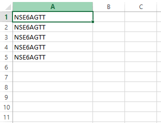

this code gives incorrect output dis sir plz see thes ample pic
