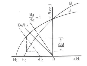

and so to clarify, the so called intrinsic B is the material property, has nothing to do with shape, that is why it is called intrinsic. very easily to be confused.
there are three kinds of B-H curves: normal curve, intrinsic curve, operating/load curve. vendor data is normally based on intrinsic curve.
HHC tests Bdi, not Bd. Bd is proportion to L/D. At (BH)m point, Bd is normally much smaller than Br regardless of Hc (I bet Ed Stainless meant Bdi, NOT Bd, is close to Br when Hc is high)
L/D is an approximation itself. if the magnet does not have a constant cross-section, it is almost meaningless to estimate permeance coefficient based on L/D. Note B=flux/S, small area section will have higher B....
I know that I should know this but I have to admit that I don't. Where does the +1 come from (Bd/Hd +1)? What is the explanation for the +1?
Clyde Hancock
Design & analysis of electric motors and generators
You need to go back and look at how Bd, Bdi, Hc, and Hci are all defined.
originally from H = 4πM + B. when magnetized, the magnet itself generates an internal field which is opposite to the external field. in the air H=B.
