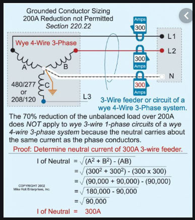

There is no universal rule allowing some maximum neutral current. Most electrical systems are configured so the neutral can carry imbalance current. See below
Neutral current in distribution transformers can be due to 1) Unbalance loads -value depends on the extent of unbalance in loading 2) Depending on the harmonic content in the load-will go up with K-factor.Neutral current can even reach 300 % of full load current 3)Small currents depending on grounding + nature of resistivity of soil 4) Winding manufacturing variation between phases - some users specify the neutral spill current ( with supply at HV ,LV shorted and current between shorted terminal and neutral) shall not exceed 2 % of line current.
