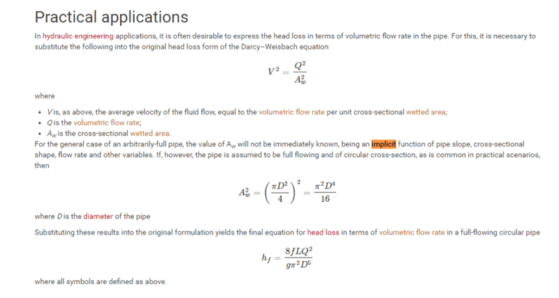

It's not Darcy-Weisbach that is implicit. Instead it's Colebrook-White that is implicit, but just for the friction factor. And, it's not Colebrook-White that is more accurate than Hazen-Williams. Instead it's Darcy-Weisbach that is more accurate than Hazen-Williams. Frictions factors are always empirical, whether estimated according to Colebrook-White or back-calculated using Hazen-Williams. Regardless, because Darcy-Weisbach is rational and Colebrook-White matches laboratory results pretty well (but certainly not exactly), Darcy-Weisbach will always be the "gold standard."
Fortunately, there are many good to excellent explicit approximations to Colebrook-White that can be used instead being forced to iterate or to work with the Moody Diagram. I analyzed about two dozen of these explicit approximations back in 2014 using Mathcad Prime 3.0 and posted the worksheets and .pdf files of them on the PTC Mathcad forums. You can find my analysis here:
If you have implicit criticism of Pump Station Design, then you should contact the book editor's for the fourth edition.
However, there are plenty of other references that agree with Pump Station Design's statement "The Darcy-Weisbach equation is the only rational formula, and it is applicable to turbulent, laminar, or transitional flow, all sizes of pipe, and any incompressible Newtonian fluid at any temperature. It has not been popular because, being an implicit equation, it must be solved by successive trials.

The point that I was making is that all of these equations have underlying assumptions and it is best not to use them blindly. Pump Station Design did state that the "Darcy-Weisbach equation is the only "rational formula" which is probably more accurate than being described as a "gold standard".
Not that it matters. I've never seen any piping system design that I could say was completed within a hydraulic tolerance of error less than the difference between any popular liquid pipe flow equation. In fact probably by an order of magnitude ... or two.

The pumping station design book is clearly in error here, which I will explain below. I have the second edition, so I don't know if they cleared this up later.
A few key statements from Pumping Station Design, Second Edition (Sanks, et al; 1998), pp. 36-37:
“Unfortunately, the formula [Hazen-Williams] is irrational.”
This statement is correct. H-W is also empirical, has limited applicability, and is explicit for all variables.
“The Colebrook-White equation is more accurate than the H-W [Hazen-Williams) formula…”
This statement is obviously incorrect because C-W and H-W do not solve the same things and therefore cannot be compared this way. This statement may be a backhanded way to claim (correctly) that friction factors calculated via C-W more accurately reflect laboratory test data than does the C factor used in H-W. Regardless, this is a terribly muddled explanation. Also, C-W is empirical, is implicit for f, and is explicit for the relative roughness and the Reynolds Number.
“The Darcy-Weisbach equation is the only rational formula…”
“It [Darcy-Weisbach] has not been popular because, being an implicit equation, it must be solved by successive trials.”
This statement is obvious incorrect because D-W is explicit for all variables. However, D-W appears implicit in practice when friction factors are estimated using the implicit C-W equation. Again, a terribly muddled explanation.
“An explicit, empirical equation for f was developed by Swamee and Jain…the value of f…differs from f calculated from the Colebrook equation by less than 1%.”
I commend the authors for providing an easier way to estimate the friction factor. However, my calculations show that Swamee and Jain deviates from C-W by as much as 3.4%. Not only that, but Jain published a modified version of S-J at the same time that is slightly better. Also, when this book was published (1998), there were at least 11 published explicit approximations for f that were as good as or better than Swamee and Jain’s equation in approximating C-W and some of these were of a similar level of complexity, including Churchill #1 (1973), Churchill #2 (1977), Jain (1976), Manadilli (1997), Haaland (1983), Zigrang & Sylvester #1 (1982), Chen (1979), Serghides #1 (1984), Monzon Romeo & Royo (1997), Zigrang & Sylvester #2 (1982), and Serghides #2 (1984).
