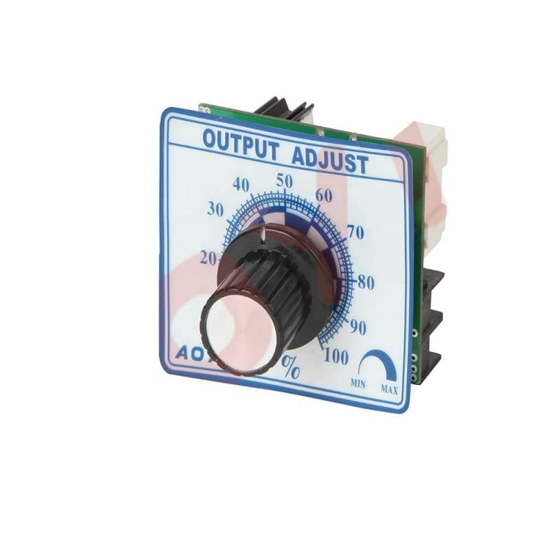

Is it possible to order VFD with separate and independent control of V and F with manual pots like controls like these?
I would like to control both V & F independently and manually (without programmed V/F). Capacity 100 KW.

This set up is to run medium and large MV motors decoupled (open shaft) in our shop, where I need to have higher V/Hz for the initial break away torque from the zero speed. Once the motor reaches about 1/3rd speed, I revert to rated V/Hz on the fly. At present, we use a AC generator-DC motor setup where I can control V and Hz separately to get the initial higher V/Hz and dial back to rated V/Hz, but this is a noisy set up. I was thinking of going for quieter VFD/Step up transformer route with independent V & Hz controls, if possible.
