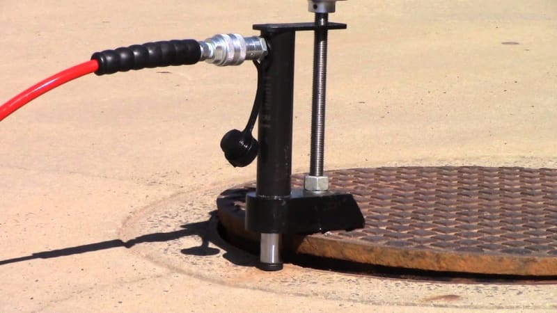

A hydrualic arm and pivot, like you get on a car bonnet might work?
Like this
or this
I doubt that hydraulic springs would work at an 800 lb lift. This is a pressure vessel. 400 psi at 600 degrees. MJCronin published a picture. Its a manway with a hinge in lieu of a davit.
