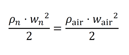

You are of course right abot the incorrectly calculated density. I attach the corrected excel file. This comes from the Bernulli's equation with the assumption that head is 0 (horizontal duct) and the static pressure is equal to normal pressure.
ps+pd+ρ⋅g⋅h=const

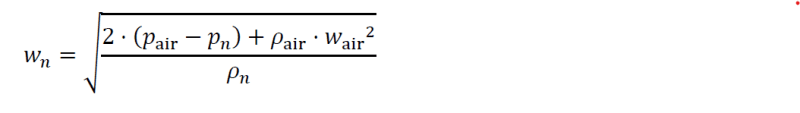

The question is, why Bernullis equation gives incorrect answer, but it is Probably because the change of static pressure is not considered. So in order to apply the Bernullis principle I should first always measure the actual static pressure in the duct. Right?
In that case the welocity of air recalculated to normal conditions would be:
Any thoughts on that? I would really appreciate some feedback from a person who does shuch measurements /calculations for living.
Review the basic equations:
P*V=Z*R*T real Gas law > Qv1/Qv2= Z1*T1*P2/(Z2*T2*P1); Qv =volumetric flowrate; T, P absolute values.
1, conditions T1, P1; 2, condition (T2, P2)
Mass conservation > Qv1/Qv2= ρ2/ρ1
> As the size of the pipe is the same V1/V2=ρ2/ρ1; V = velocity
No Square root

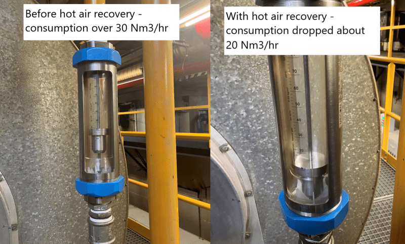

There is another issue though, maybe connected to the moisture in air. Different duct, different condition. There is a new installation of hot air recovery from one of the oven to the another. Using hot air instead of fresh air allowes to save on gas consumption. These are lacquering ovens (they extract the solvent from the lacquer and then cure it)
d= 250mm -> A = 0,096m2
trec = 291°C - Temperature of exhaust gas in the duct
tamb - 31 °C - fresh air intake
pd - 0,2116 mbar - Average dynamic pressure (several sets of measurements)
w - 8,22 m/s - average air velocity in the duct
F = 0,791 m/s = 2848 m3/h = 1783 kg/h - flow of pre-heated air in the duct
Fn = 1379 Nm3/h - flow at normal conditions
cp = 1026 J / kg * K - specyfic heat of air
Using the pre-heated air at 291°C instead of fresh air at 31 °C in theory is equivalent of energy saving of 476 MJ/h or 132 kW.
cgas = 35,17 MJ/m3 - calorific value of natural gas declared by supplier
In theory this should save usin 13,522 m3/ h of natural gas, but in fact this is around 20 ( I can see it directly on the rotameter for natural gus before the burner). The difference was instatanous and remained. Also the indication on the rotaeters was stable before and after the hot air recovery on. The humidty of the air was around 80 % at that day (temp inside 30 °C, outside 15 °C ). How can I add this humidity to the heat capacity of air?
So the results are way better than in the calculation, but for the future I need to know how to calculate it properly.
BTW It is not my project, I joined when it was already starting up.

Basically, you have to perform mass and Heat balances to calculate the improvement using hot air.
I've added a document related to humidity to help you out.
Note: I'm not sure that your Rota meters are the best technology for measuring your consumption of NG. You should perform your balances over a period of time to reduce the discrepancies, let say a day, a week, a month, the best way being the comparison of the monthly bill before and after the change.
Good luck
Pierre
