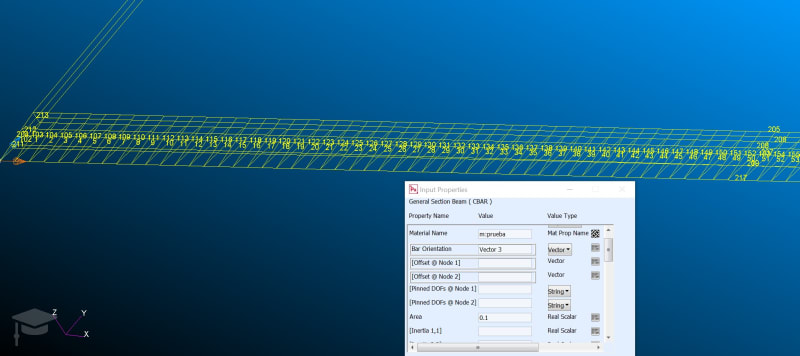

I have done that by defining 1D elements using the property CBAR (we are free to use the elements we want). I have used a bar orientation that is perpendicular with the union I want to make and a ''random'' area. To not waste too much time I've only tried that on a part of the structure.
Como veo que eres español aprovecho a explicarme en castellano también.
The problem I see now is that in the analysis the elements act very strange, as they were different parts of the structure. I'm used to use only 3D elements and the performance is very different.
El caso es que mi estructura no se comporta como si fuese un sólido, es decir, si yo le aplico una fuerza en una esquina (que es lo que he probado) debería deformarse conjuntamente de una forma ''lógica''. En este caso parece que cada elemento va por libre respecto al resto. Posiblemente esté diciendo barbaridades pero dada la inexperiencia con este programa y estar atascado en esto...
Can you upload your Nastran bdf file?
