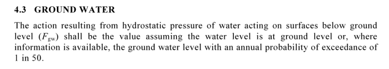

The code defines H as groundwater pressure and specifies a load factor of 1.6. Not sure I'd be comfortable (or have any justification for) using 1.2.
My guess is that they intended a stability FOS wrt the buoyancy.
In AS/NZS1170.0 (AU/NZ loadings code) we are allowed to use 1.2 based on the water level being defined as follows:-
In reality the annual probability of exceedance criteria is impossible/difficult to evaluate unless you have long term ground water records, taking the water level to ground level is often overly onerous. Otherwise a 1.5 load factor is required due to the higher risk of water level not being known with certainty.
I would expect 1.2 factor is acceptable for uplift forces and 1.6 for horizontal forces. Looks like the code language is not specific about this but that would be my inclination.
