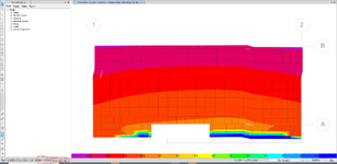

I am analyzing Mat foundation using SAFE Model, having a soil pressure of 82 kPa. But the allowable is only 40kPa. I have increased the depth of MAT foundation, yet the model shows same pressure. Can anyone explain me why the SAFE is showing me no change in soil pressure. It will be a great help. Thank you.

Does the pressure under the footing look uniform currently? Or lots of localized peaks?

It's almost uniform. It does not have any peaks. I have attached snip for a quick look. The settlement also looks impractical.

Yes, your understanding is right. The Mat foundation is on clay. The Client is not okay with Pile foundation, Geo technical engineer has given me a soil subgrade modulus of 500, which comes to the bearing capacity of 40kPa. What solution I can provide in this situation. The model is also showing me Irregular settlement as shown in the snip & also attached soil pressure distribution for envelope. I have ULS Load combinations + Nonlinear Uplift cases for envelope.

If the safe bearing pressure of the soil is only 40kPa and the average soil pressure 65 kPa , you can not reduce the pressure to 40kPa with increasing the mat thickness and /or softening the springs . The average settlement 120 mm corresponding to the 65 kPa implies you have adapted K =550 kN/m3 which is too low .
If the safe bearing pressure 40kPa, and assume SF= 2.5 and corresponding allowable settlement is 10mm
The Winkler spring constant should be around K=40*2.5/0.01=10000 kN/m3,
The structure could be equivalent of six storey bldg and IMO, you have two options ;
- Provide a basement storey to reduce the effective stress ,
- Consider soil improvement or piling .
Say my opinion only,
Foundation rigidity is relative to the subgrade modulus. Given your low modulus and uniform soil bearing stress, it appears that your foundation is already rigid in this sense. So it makes sense that increasing the foundation thickness is not improving matters

Once you have approach a rigid condition you can thicken the mat as much as you won't and you won't increase the area. How about widening the foundation? Surely this engineering 101?
Seems to me that the next steps would be to explore a larger mat as noted above or to push the client towards deep foundations. Client preferences are important, but if the numbers don't work than you have your answer.
