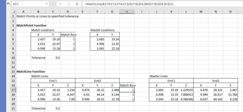

I have modified Skip's code from the other thread for MatchPoint and MatchLine functions:
Code:

Function MatchLine(End1 As Variant, End2 As Variant, MasterEnd1 As Variant, MasterEnd2 As Variant, Optional Tol As Double = 0.1)
    Dim Numrows As Long, NumCols As Long, TolSq As Double
    Dim DistSq As Double, row As Long, col As Long
    End1 = End1.Value2
    End2 = End2.Value2
    MasterEnd1 = MasterEnd1.Value2
    MasterEnd2 = MasterEnd2.Value2
    Numrows = UBound(MasterEnd1)
    NumCols = UBound(MasterEnd1, 2)
    TolSq = Tol ^ 2
    For row = 1 To Numrows
        DistSq = 0
        For col = 1 To NumCols
            DistSq = (MasterEnd1(row, col) - End1(1, col)) ^ 2 + DistSq
        Next col
        If DistSq < TolSq Then
            DistSq = 0
                DistSq = (MasterEnd2(row, col) - End2(1, col)) ^ 2 + DistSq
            Next col
                 MatchLine = row
                 Exit Function
            End If
        End If
    Next row
    MatchLine = CVErr(xlErrNA)
End Function
The MatchLine function searches for a matching point at end 1, then checks if the other end matches. This assumes that all the lines are specified in the same direction. If you swap End1 and End2 it won't find the match.
The MatchPoint function is essentially the same as Skip's function, just changed to suit my preferred style.
Both functions will work with 2 or 3 dimensions (or more) and return the matching row number, rather than a string.
