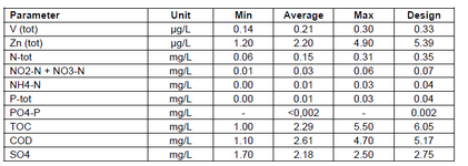

Hi All,
I have been asked to check the compatibility of Lean Duplex Steel for Industrial water, spec give below. I wanted to know how I can check this. On checking this forum I found that there is Langelier index which tells you if Caco3 will precipitate or not, but then how do you check if the material is suitable for this spec.
Thanks and Regards,
Pavan Kumar

Normally with a scaling index (any of them) the water either scales or it dissolves metal.
However, with SS there is little risk of dissolving metal.
The issues in SS are pitting or crevice corrosion.
So you look at Cl (+F), pH, and temperature.
There are a number of handy sources for pitting limits for various SS alloys.
Considering that lean duplex grades are generally equal-to or slightly-better than 316L.
Though unless you are doing this for strength reasons, if this water will never scale 304L might work just fine.
