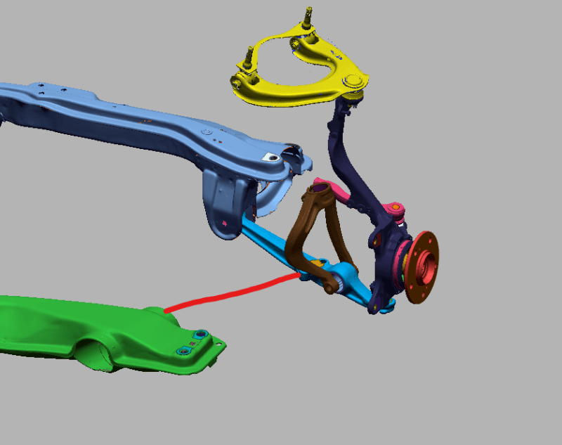

Thank you guys for your answers,
As a general message what I get from your replies is "don't try to outsmart the OEM, they know what they are doing". And, having worked for several OEM's in the past I do agree with you.
However, despite not being a show car, the point here is trying to get an old looking car and give it a modern, lightweight, precision engineering look by doing something different from what the OEM did in the first place.
To give you more information, the car is a '91 Honda CRX and below you can see a screenshot of a 3D scan of the original parts (the red line is a reaction rod missing from the scan that connects the front subframe with the lower control arm to support braking and accelerating forces) :
The main idea is to remove the 2 subframes and design 1 single spaceframe structure that connects all the mounting points, as well as redesigning the knuckle, lower control arm and upper control arm.
I'm using the accuracy of the scanned geometry to replicate the suspension in a MBS software to understand what are the loads of the OEM suspension as well as all the geometry parameters, to try to understand what was designed to do in the first place and try to replicate it in the best possible way.
Does anyone recommends some resource regarding material choice for these applications?
Thank you
If I remember right, that generation of Civic pre-dates the use of full subframes. The "subframe" at the back hangs onto the inner ends of the lower lateral links and has the steering rack (not shown) attached to it. The driveshaft (not shown) also sneaks through there, through the middle of the hole in the brown bracket and I think it passes in front of that whole subframe. The front crossmember (green in your illustration) supports the trailing links, which intentionally have soft bushings for NVH isolation. The front antiroll bar (also not shown) also connects in there somewhere. The engine mounts go to the unibody because there's no full subframe. The soft bushings in the trailing links are meant to have minimal effect on the handling, because the lower lateral link and the steering tie-rod form a parallelogram, so slight fore/aft movement of the knuckle due to bump impacts have little effect on the steering. The various connections between the lower lateral and trailing links and that funky-shaped strut bracket have to accommodate the various twists and turns of all this as it goes up over bumps, and as it gives way a little bit from fore-aft bump impacts (or acceleration or braking forces). Hence ... bushings with some give to them.
This is a highly optimised design from the OEM. It, and the unibody around it, is also safety-critical. Speaking from observation (cars broken at the side of the road ...) if the lower ball-joint fails (and it's under tension from the weight of the vehicle, which does not help matters) the whole thing collapses. It isn't perfect. The MacPherson design that Honda used before this, and then switched back to a few years later, doesn't put the vehicle's weight through the ball-joint in tension.
I know this platform has had more than its share of aftermarket support over the years. Begs the question ... what are you trying to do, that hasn't already been tried?
