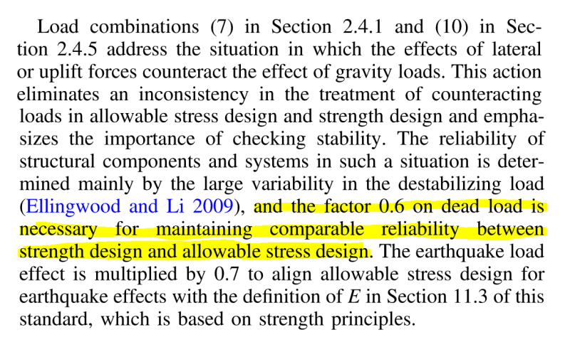

@Chris3eb - I had never read or heard what you highlighted regarding the 0.6D being similar to 0.6W in that the 0.6 was used to bring it in line with strength design. I'm not sure that it changes the argument for the increase to 0.6 if you know the weight precisely. Couldn't I argue that if I'm using LRFD where the combo is 0.9D and, saying I know the weight precisely, I'm going to decrease this to 1.0 is the same, in concept, as increasing 0.6D to 1.0D for ASD?

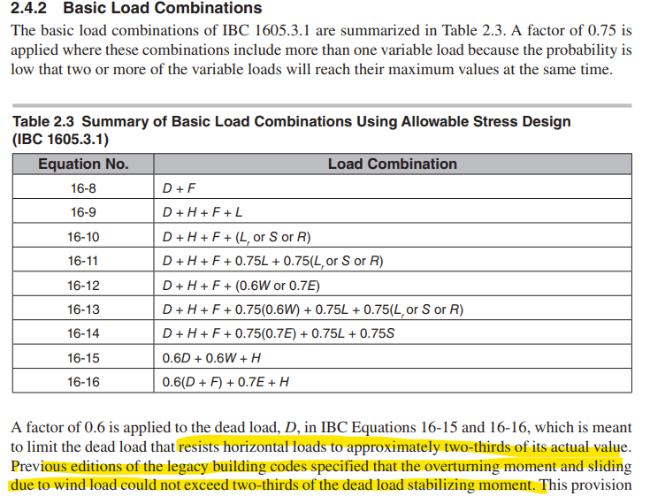

Interestingly I see this note in the link that PhamEng just posted.
If we are limiting something to 2/3 it's actual value then, I would argue, this is a FOS.

So now I have two ways to look at the right side of the equation from my first post;
EQ2) Pn/1.67 ≥ 0.6DL + 0.6WL
1) ASCE 7 Commentary - No factor of safety added. 0.6 added to bring ASD in line with LRFD.
2) IBC - 0.6 factor added to ensure a only 2/3 DL used to resist overturning (they call it a "factor" but not a "factor of safety"...not sure I see the difference here.
Which explanation is correct? I'm leaning toward the ASCE explanation since that would also address why there are no load increases to DL or SL in EQ1 below.
