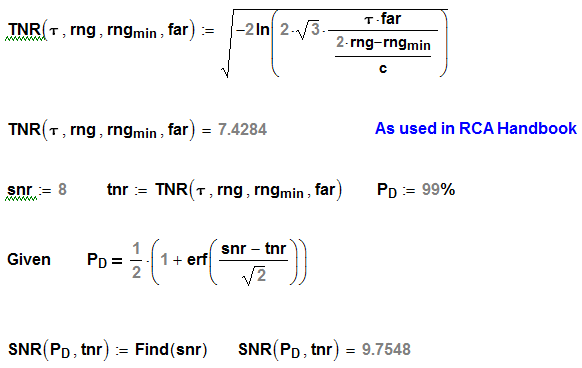

> Solve block -- Given blah, find(x)= Numerical solutions to constraint or simultaneous equations are relatively easily done. This feature allows you to spend more time working the problem, rather than spending time setting up the equations. One really nice feature is that you can assign a solve block to a function, and then iteratively ask for solutions to a range variable, like h = 0 to 1 in steps of 0.1

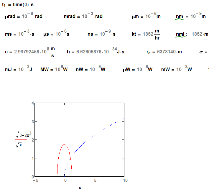

> no brainer graphing -- on a blank sheet, you can type "@" to pull up a blank graph, type in an expression in the y-axis, and type x in the x-axis and voila!, you get a graph that defaults to -5 < x < 5 without doing anything else. I've recently used this a lot when helping my son with math homework

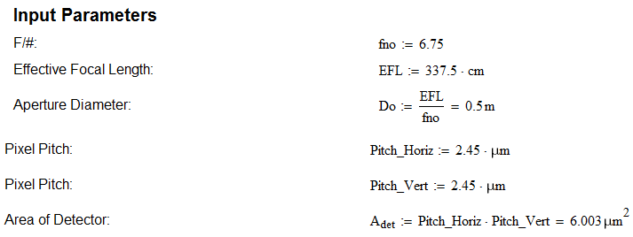

I never used it for super in-depth calculations, but I did write a 17 page calculated analysis in the format of a report that I could send a customer in MathCad. It turned what used to be a couple hours worth of calculations and equations into about 20 parameters in a hidden block that would automatically populate the answers throughout the report. It is an amazingly convenient program.
I love it because it handles UNITS like childs play, makes it VERY obvious if there is a mistake which my biggest complaint about excel, and it shows you equations in a way that you would write them on paper, for ease of following.
