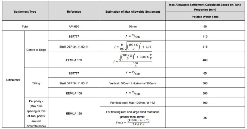

Most of my analyses have been to limit total settlement to around 1 inch, and differential settlement to around 1/2 inch. With vertical water tanks, we always recommend they be filled in stages and monitored to make sure they don't start to tilt, before they are placed in regular service.

Tiger Guy, that must be for relatively small diameter tanks? For large tanks, which are typically flexible structures, the settlement can be hundreds of mm.
I've analyzed numerous grain bin structures for settlement on deep clays. Settlement estimates of 6 to 8 inches (150 - 200 mm) are quite common. On large diameter tanks and bins, the base is flexible, with nearly double the settlement in the center as observed at the edges.
By filling in stages, the settlement takes place at a slower rate. Some flexibility in the connections is added to the design to accommodate this movement.
The real trick is to make sure the base doesn't flex so far that the connection to the sidewalls is compromised. We covered a case study in university on one of these, it made a mess. When I've encountered sites this soft, I usually recommend the placement of some thickness of aggregate base beneath the tank floor. Just like a pavement design, add a stiff layer and improve performance.
