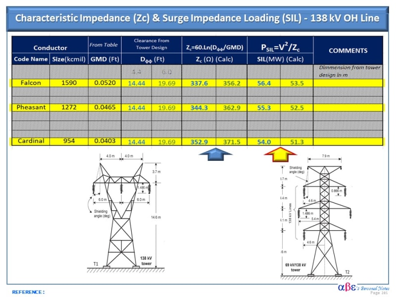

Transmission line loadbility is determined by multiple factors. One of the dominant factors is Surge Impedance Loading (SIL). For 138 kV transmission line the SIL138kV≅ 50MVA. At best, the 138 kV operating in the thermal region can delivery for a short line 150 MW. So for 800 MVA at least 6 parallel overhead circuits and associated ROW and permitting.
For longer distances, a higher number of circuits are needed since the reduction in T. Line transmission capacity will be expected to operate the line in the voltage drop region or more severe in the stability limits zone. An economical analysis is recommended since appears a higher transmission voltage could be more cost-effective. A double circuit line is an option to reduce tower cost and ROW.
For illustration purposes, see the normalized T. Line Loadability curve below.
Hope this helps.

Surge impedance loading... what are the disadvantages of running a line overs its SIL? 90-95% load power factor? Unity or otherwise obviously I will be drawing extra current to support the lines reactive needs limiting MW transfer.

c) Why SIL is one of the dominate factors?  To evaluate transmission line performance, conductor rating ampacity is not enough. For example, a better indicator of a real power transferred in a radial line is P=Es.Er/X.Sin(δ). The max. power is achieved if sin(δ)=1 (δ=90o) and also if the receiving end and sending end voltages Es=Er. In this case PSIL = V2/Zc.
An example of the SIL as a useful indicator of the line performance is as follows: 1)Line loaded @ the surge impedance the voltage profile is constant along the line. 2) For load > SIL voltage is reduced at the receiving end and the opposite happens that may require shunt capacitor or reactor compensation for heavy and light load respectively.

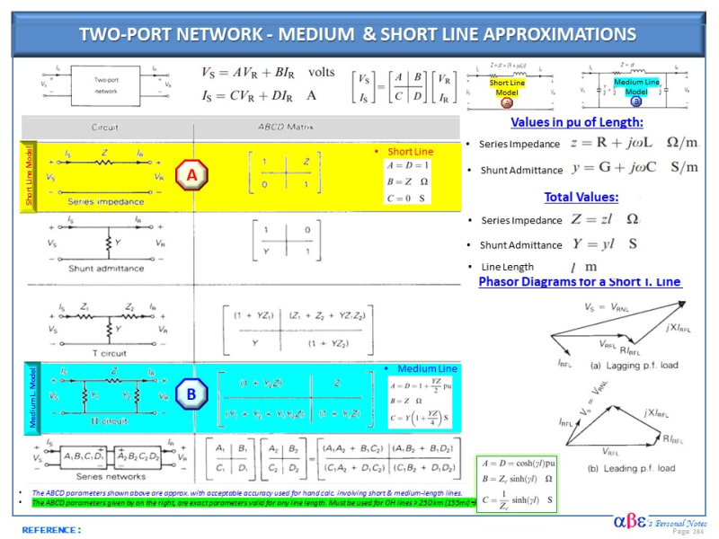

Many of the questions above are focus on the voltage drop (VD) issue and how this is related to the traditional approach to calculate it.
First, we need to understand the model used for those calculations:
[ul]
[li]-The traditional voltage from the formula is derived from a simple series resistance and reactance circuit.[/li]
[li]-This provides a good approximation for a short line.[/li]
[li]-For medium line length, a Π circuit model provides more accurate results[/li]
[li]-A shunt admittance (Y/2) is introduced modifying the traditional equitation somehow more complex.
[/li]
[/ul]
I hope this forum doesn't get tired of illustration. This indicates two circuits (A & B) to model a short line and medium-length lines using the Two-Port Method to determine the associate voltage drop.
An interesting observation to keep in mind is that during the light load scenario, rather than decrease, the receiving end voltage could increase (Ferranti effect) due to the distributed capacitance along the line.
It should be noted, that a proper design the line regulation should consider the effect at not load (voltage rise) or at full load (voltage reduction) and switch shunt reactors or capacitors to maintain the receiving end voltage within the ISO window usually ±5% of the nominal system voltage. In any circumstance, the rising voltage should exceed the maximum equipment rating.
Let's focus now on the 600 MW transmission. If we could pretend for a minute be in a Utility Planning Department, the first option to suggest is a double circuit at 230 kV OH line to delivery Ptotal=600 MW considering the following:
[ul]
[li]SILpu≅2.4 for 70 miles line length.............>>>Estimated from the curve above<<< [/li]
[li]1 pu SIL230kV=134MW; .............................>>>Assumed from table above<<<<[/li]
[li]∴No Lines=Ptotal/ (SILpu≅2.4 xIL230kV)=600MW/(2.4x134MW)=1.87≅1-Double circuit line.[/li]
[/ul]
The voltage drop will be within ±5% of the allowable voltage range 218kV< Voperation<242kV
To meet the N-1 reliability criteria, an additional line is required.
[ul]
[li]CONCLUSION: 3 lines are needed at 230 kV[/li]
[li]OPTION: Install a series cap bank capable to deliver 600 MW in the event that the second line became unavailable.[/li]
