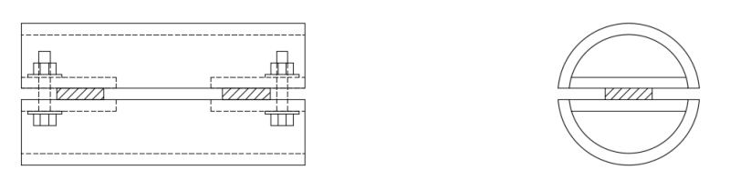

I like the cut in half thing. How about you take a pipe, slice it in half and rig a load cell or two such that they connect the two halves with a bit of a gap for movement. Then when you tension the tie around the pipe it loads the cell.
You could probably rig the same thing by using spring scales, but it'd be fiddly.
I had a similar thought, but using a short piece of flexible tubing filled with water or oil, and a pressure gage - install and tighten the cable tie and measure the pressure rise on the filled tube.
Yeah, calibrating that might be tricky though.
Here's what I'm thinking. Hatched items are load cells. Bolts are finger tight and just there so that the whole thing doesn't awkwardly fall apart when you take the tie off. The plate I've shown inset in the cut pipe should really be mounted outside for ease of assembly rather than being inset. In retrospect, maybe the bolt should be past the ends of the pipe so you can actually insert it.
Details are left to the imagination of the person getting paid to figure this out :D

If you're just trying to gauge consistency, this is fine. If you're looking to put a number to it you're going to have problems. You're going to have to test the exact installation somehow.

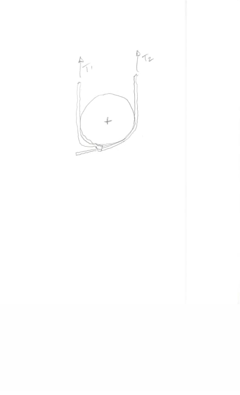

Wrap 2 ties half way around a cylinder, measure the tension on the ends of the tie. If you mount the cylinder in bearings then the 2 tensions should be equal:
