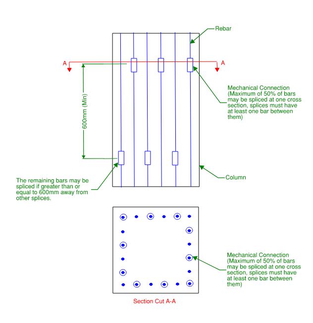

Hello Engineers,
Thanks.
As per the figure you haave posted,as far as I understand, at any section ,50% of bars allowed to be spliced.. and the vertical distance between splices 600 mm or more..
You may consider splicing of longitudinal column reinforcement every other floor to reduce congestion and make economy..

I think, I had mistaken about the spacing of 600mm. As HTURKAK said that the code says 600mm distance is between the alternate splices in a row or layer of rods. So if I have 5 bars in a layer and assuming that the corner bars will go without splicing, i can spice 2 rebars (2nd and 4th bar) in that layer. The spice distance between these two bars has to be 600mm. This 600mm is not between the multiple sections which I had thought first.
Now, can I splice bar no. 3 going some more up by say more than 600 mm?
What does the code mean by 'at a section'? Can I have multiple sections for a column in a story.
If I'm to splice more than 50% rebar by mechanical spices, then I have to have two sections in a story.
If 'at a section' means 'in a story', then it by default means I can go up to only 50% splicing by splicing the alternate longitudinal bars at a section.
I would be glad if you clarified my confusion.

Mr DAUWERDA nailed it and a pink star for him.. The picture that you posted shows the welded or mechanical splices on the same storey and if you splice the alternating bars , literally max 50% of bars spliced at any section for rectangular columns with symmetrical reinf.
Personally i prefer splicing of rebars at every other floor to reduce congestion and make economy..
