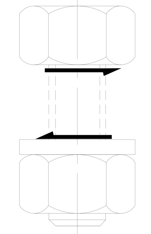

I am trying to determine bolt stresses from a resulting shock load. A component is bolted to a mounting plate and the mounting plate is bolted to a fixed structure (see attached sketch). The system sees some acceleration due to shock. We cannot bolt the component directly to the structure since it would require significant modifications and a design change (negative impacts to cost, schedule, yada yada...). Assume symmetrical loading, bolt patterns, and components. The qty. 12 bolts sit in counterbored holes to prevent contact with the component.
I am mainly concerned with the stresses in the qty. 12 mounting plate bolts. I determined that the bolts are sized such that a preload could be applied to provide sufficient clamping force (thus friction) to prevent slippage of the members. I then treated this like a cantilevered beam and the fixed end is the mounting plate bolted connection. So, due to symmetry of loading and geometry, I assumed half (qty. 6) of the bolts would be in tension. I only solved for stresses due to tension in these bolts after finding bolt/member stiffness.
A coworker of mine says that I should account for shear as well. He says that due to possible variations in workmanship, the bolts could be in bearing when installed and the clamping force would not help in this case. I disagree, but I have been wrong before; what do you guys think?

You should not count on friction to carry loads. You should check the bolts and plate bearing strength for the applied shear loads; probably reasonable to assume even distribution of bolt loads.
Hi DLJ Eng
I agree with you, if the bolts are pretensioned so that relative movement between the clamped plates cannot occur then the bolts won’t see any shear. Consider that all the 12 bolts are concentric within the bolt clearance holes, if the plates can’t slide the bolts don’t see any shear. Now with the preload identical as before but with only six bolts concentric in the bolt holes and the remaining six bolts in contact with the side of the clearance holes how would the bolts see shear if the plates can’t slide?
That said, I would ask how confident you are that the bolt preload is sufficient to prevent relative movement between clamp plates because friction is usually highly unpredictable?
Your co-worker is correct if the plates can move.

I'm not so sure... even without bearing against the bolt shaft. Shear is transferred from the nut to the bolt on the other end. The bolt shaft is still in shear. Maybe most through friction, but some has to be part by bolt shaft.

Yes, assuming no friction, on initial loading only some of the bolts will be loaded, but as the load approaches the ultimate load level, there will be local bearing deformation in the holes and deflection of the bolts, and therefore the bolt loads will approach uniform load distribution.
Therefore ion this case it is reasonable to assume a uniform load distribution of loads to the bolts for purposes of checking plate bearing, bolt shear strength, etc.

I found this link which covers a point which dik mentioned about shear transfer at the nut/bolt head surface, however according to the site this is quite negligible and goes on then to consider bearing and shear on the bolts
For what it’s worth DLJ Eng one might as well size the bolts based on the the information you have already and just check should the bolts see bearing / shear forces just check the bolts can handle it.
