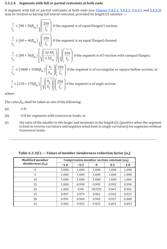

Is there any rule when to use section capacity and when member capacity? Does member capacity include secondary effects already?

Agree with Josh that we need more info. But generally, section capacity and member capacity converge when member stability is satisfied through bracing, etc. If a member has to rely solely on its internal stiffness for stability (such as resistance to LTB), the member and section capacities will typically diverge with the overall capacity of the member being lower.
Your profile says Australia and terminology makes me think steel, so some extracts from AS4100 are in the image below for bending and compression. For bending, you can take Beta_m to be -1.0, Fy = 300MPa for rolled sections, Fy = 350MPa for hollow sections, to get simplified conservative limits. For compression, you can see that member capacity = section capacity for lambda_n < 15, and the reduction in capacity is still small for lambda_n = 25.
