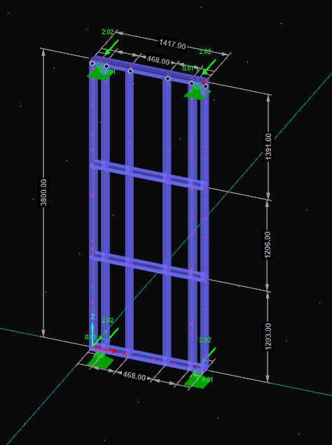

I have a stud frame wall which holds the terracota cladding laterally restraint while all the dead load is transferred to the concrete slab.

I have only looked at previous calculation report for sfs and did the same thing it is an SFS panel which will be carrying laterally supported terracota.
Currently the SFS frame was in raw state in panel by panel format, there was no terracota yet and it was in temporary state with 2,2 Concrete screws and yet the screw failed from top and the panel fell to the ground.
Now i am having hallucinations that everythign is wrong my complete anaylsis is not correct it is just a pile of worries, I am getting or panicking.
I am attaching a F.E.M model screen shot for the SFS panel how does it look like.
Currently it has cement board and insulation installed.
in Future it will be carryign terracota and terracota fins on its sides.

A sketch showing the bearing, and framing would be better than a screenshot from the model. Something like what you will give the trade to use in the field. Sketches to illustrate your problem are extremely important.
Relax, this does not seem outlandishly wrong from a general perspective.
XR used to do a ton of this design in North America years ago. The naming used here is very different, so you would need to show a sketch of the profile.
1.5mm is about 16ga here. Can't imagine screws pulling out of that easily. Did it pull out or did the screw break?
I have done a lot of cold formed steel framing design, and here are my comments:
Stud spacing 468 mm = 18.4", seems reasonable.
Stud height 3800 mm = 12'-6", seems reasonable.
Stud gauge 1.5 mm = 16 GA, seems reasonable.
Bridging provided at 1391 mm = 4'-6", seems reasonable.
SFS appears to be a proprietary panel and facade system - am I getting that right? If so, contact the manufacturer to discuss what happened. It appears to be a simple installation error by the contractor.
I hope this gives you some peace of mind!

I agree with Dave, if anything that stud assembly could probably even been 18ga and been fine, which supports that it was more likely an installation error.

@daveatkins you are on point, The screw which was installed had bad strentgh or you can say was not manufactored according to its said strentgh.
now Hilti Concrete expansion anchors will be used.
