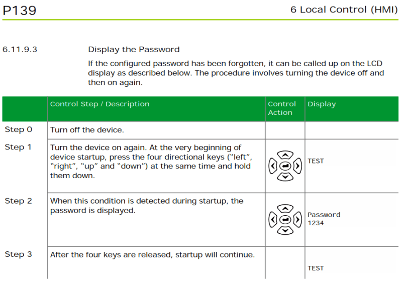

Hellow, I have encountered such a problem. When I try to send ".hex" (bay template configurator file) to the relay Micom P139....633, the Easergy Studio shows message "Now set the device to loading mode and confirm with the OK button". To enter to relay "loading mode", I'm switching off relay power supply, then pushing buttons "C" and "Enter", after that turning relay power supply on. Then message with request to enter password (8 symbols) appears on the relay screen. What is the passwords maybe know someone?

Here are the steps to display the password (from the manual):
Thanks, but this password is for "Password-Protected Control Actions".
I got "loading mode" password, perhaps will be useful for someone. This is arrow combination: ↑ ↓ ← → ↓ ← → ↑
