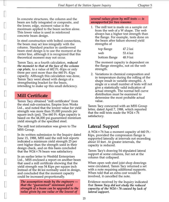

I haven't used it myself, but recall mention here of a clause (IBC?) that prohibits the application of mill certs to get capacities/properties better than the material specs.
(But if you can identify that steel is actually A992 instead of A36, that's OK)
You might search for that.
I actually stumbled upon this exact scenario when browsing this recent thread: Link
See lexpatrie's mention of the Station Square collapse
wiki said:
Steel strength
The MSS Group recommended strengthening the beam above the column by adding a beam bracket with web stiffeners. This change was not implemented when Tamm Tacy advised that mill certificates obtained from the steel sub-contractor indicated to be 25% higher strength than expected. It was later determined that this type of data is not a truly representative sampling of the steel as fabricated and so is not a valid measure of actual strength.
See this link for the final report for that failure: http://www.llbc.leg.bc.ca/public/pubdocs/bcdocs/43459/commissionerinquirystationsquare.pdf]Link[/url]
So, I'd agree with others here. Don't rely on mill certs to "increase" available strength of your beams or connections.

The AISC code is clear that the design strength is based upon the specified minimum yield stress of the steel type used. The safety implication of using CMTR values is the reduction in the AISC factor of safety or safety margin.

There are statistical methods for analyzing a set of sample strength data to estimate a lower bound strength, for a specified level of reliability and confidence. We do this all the time in aerospace to get material strength allowables. I seem to recall seeing similar methods published for use with civil structures materials. Just using the lowest test value is usually not acceptable, unless your sample size is very large.

The objection (as I recall) with the mill cert is it was for the full heat, i.e. a lot of the steel, meaning it was a point sample that wasn't statistically significant (i.e. less than 30 tests), would be my comment there, I think that's the objection the committee and various investigation folks had as well.
I'm not sure you can get a mill cert for a specific piece of steel. That sounds like a misunderstanding of what the mill cert was/is.
If, maybe, you can rule out the other forty eight things that went wrong with Station Square, maybe this degree of overstress (which is "on paper" at this point), maybe that degree of overstress is more tolerable, but you'd really want to recheck everything surrounding the calculation, i.e. is there any extra dead load that was missed, was the beam section transcribed wrong, did the contractor add any extra weight, installed with natural camber downward (Does the bolting even permit that?), etc. We tend to design steel beams for full width of dead and live load, rather than having some of the load at the ends going into the girder, which is at least a potential secondary load path, if not how they actually behave. (I just got a hold of Fling's concrete book from the local library and that's why I mention this).
