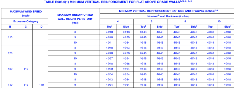

The 2018 International Residential Code has tables for this.
The ACI minimums typically do not apply to ICF's

Right or wrong, I think the greater spacing of horiz. reinf. comes from IRC for residential basement walls less than 10' tall. See IRC R404.1.2(1. If your wall is greater than 10' or otherwise beyond the prescriptive requirements of IRC, I think you are required to design the wall per IBC and therefore would need to follow ACI minimum reinf. If you fall within the prescriptive requirements you are able to use IRC reinf. requirements if you choose. There are several threads on here from the past about the differences in IRC and IBC requirements in regards to horiz. reinf. in basement walls.
While there may be some slight differences in curing for IFC vs formed concrete walls, I don't think this is why you have less reinf. I think the 48" spacing option is likely in order to compete with formed walls that are being built per IRC requirements.
