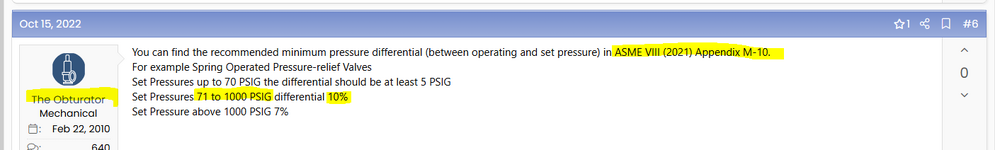

For the record. Recommended differentials between operating and set pressure are to be found in current ASME VIII-I (2023) M-10 (c) as copied below (same as earlier edition ASME VIII (2021) M-10 referenced earlier in this post). It does exist. strange that you say you cannot find it. Look it up in the index at the front.

Thank you The Obturator, I was able to locate this section in Non-Mandatory Appendix M-10(c) in ASME Sec VIII (2021). I was searching in the Mandatory Appendix 10 which is why I could not find it. Apart from 10% differential I must also consider 7% blow down for the PSV set pressure correct?. So with my Set pressure of 7 bar(g), with 7% blowdown the the re-seating pressure would be 6.51 bar(g) and with 10% differential the maximum operating pressure would be 6.3 bar(g). So having an max operating pressure of 6.3 bar(g) with PSV set at 7 bar(g) is adequate.
Thanks again.
