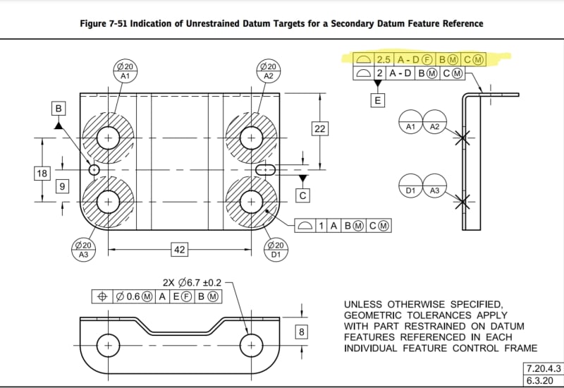

According to sub-paragraph 7.20.4.4 in ASME Y14.5-2018, datum features of size referenced at MMB can participate in restraining the part (producing a restrained condition). The sub-paragraph refers to figure 7-52, which doesn't include a detailed restraint requirements note (a detailed note is available in figures such as 7-27 and includes mounting instructions with fasteners and torque data).
Does anyone have an idea, or can provide an example, of how the four pins used as datum feature simulators of datum feature B in figure 7-52 can be used to apply forces on the part?

Simply holding the part tabs flat may not align the pins with the holes and vice versa. It may be the the pins will ride against the closest tangencies of the holes with the pins or the farthest tangencies.
I have encountered a number of actual parts that behave just like this - squeeze the part to allow the screws to be installed and then tighten them to hold the tabs flat.

So if the part is deformed enough it may be necessary to force it to fit the MMB simulator pins and that way the pins take part in restraining the part. That makes sense if the part is indeed very deformed, but if the deformation is more moderate and there is sufficient clearance between the holes produced within their size tolerance and the MMB simulators, there might not be any restraint acting through the pins, right?
So the restraint note on both A and B is a requirement on the drawing, but it looks like it will not always be met (for B), and not always necessary either - it could be applicable or inapplicable (for B) per the actual produced part geometry, isn't it?
Would you say that a restraint applied by MMB simulators also makes sense in the upper segment of the control of datum feature E in figure 7-51 (see below)?
The secondary hole and the tertiary slot are used to restrain the part, while the primary datum target planar areas are referenced at free state. In addition to the "deformation not guaranteed" issue from the previous case, I would say that with that part geometry, it looks like it would be difficult to squeeze or stretch or twist the part by force against the MMB pin and tab that will be used as the simulators for the secondary and tertiary B@M and C@M, especially without applying any force against the primary A-D simulators. Would you agree?
It's possible the part is perfectly formed and the flanges are perfectly co-planar and there is no need for any restraint.
The difference is that if the flanges are perfectly co-planar, you can still apply a restraint on them.
If the datum features of size can fit over the datum feature simulators without flexing the part, there will be no restraint.
It appears that the restraint specification for a datum feature referenced at MMB is an optional instruction - there will either be forces applied against the simulators or it will act as a free state datum reference without being modified to apply at free state.

The plainly hostile and smarty-pants move was ridiculing the issue with that "FEA for each actual part" BS and asking "how long before you run out of Y14.5 examples to analyze?" when I was trying to get a clarification about restraining parts by datum features of size. At what stage did you make the bet with your co-worker? If you cheated the bet by provoking an argument, shame on you for taking that candy.
Fortunately, the standard actually did a decent job at clarifying that restraints applied to features of size datum references at MMB do not require contact between the datum features and simulators. This is explained at 7.20.4.5, and it's something that I missed. And it solves the problem, because it confirms that a restraint on such feature is only optional, and it can essentially end up as a free state datum reference. I'm not surprised that you didn't point that out.
