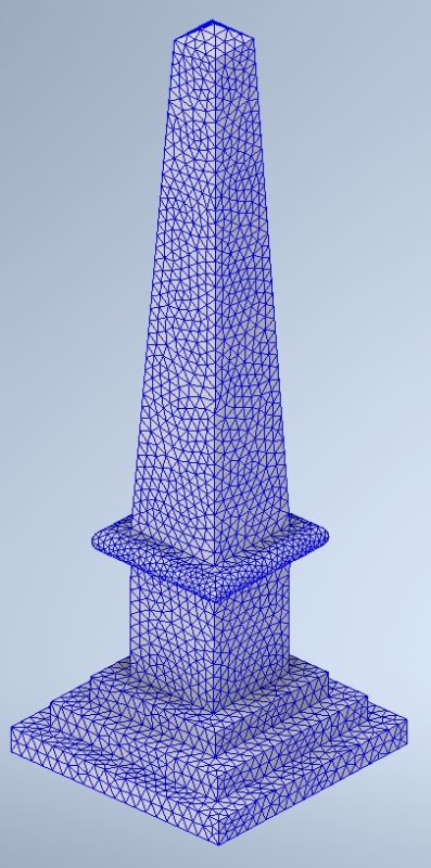

Usman3301, whoever set that deadline pretty much set you up to fail. For something like this you need a solid modeler like Inventor, Solidedge, or Solidworks. Then an FEA program that will read the file it creates. Just to illustrate, I made a rough approximation of your model in Inventor. Then I meshed it using Inventor Nastran which is embedded in Inventor (if you pay extra money.) When I say, "I meshed it . . .", I mean I hit a button that says "Create mesh".
I don't know anything about using granite for construction but I assume these are granite blocks. Are they adhered to each other somehow or do you just let gravity and friction do its thing? If the latter, this would be very tricky to model because you couldn't allow any tension normal to joint.

I am just guessing here but I think your model is wrong. It seems that you have assumed a solid structure and my impression is that it is hollow. There is a staircase at the base and an opening, also something that can be a window near the top. But I may have misunderstood [smile].
There is also a question of purpose for the analysis? I would not be surprised if this could be done "by hand" in a few hours.
Thomas
Thomas, this was just a quick and dirty model to show Usman3301 another way to go about it. I see the door and window and stairs so, yes, I do assume it's hollow.
