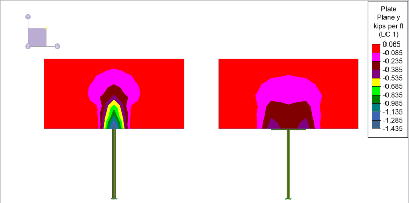

I am struggling with this one. I have this very old tank (100+ yr) that is still functioning, so we know its OK. I need to perform some assessments on it. Am modeling it using SAP2000
The model consists of the tank modeled as shell plates, a riser that goes up to the tank (also shell plates) a ring girder that surrounds the tank at a certain elevation (frame members connected perpendicularly to the tank through rigid links), and a tower that supports the ring girder and the tank along with it.
Global analysis and reaction all made sense and were within a small % of expected reactions from Water, Dead, wind , etc...
Here is my problem, according to one code am following, I do need to use the Von-Mises stresses and compare them to the allowable stress, the problem is my steel is 30 ksi and the stresses am getting are relatively high (goes up to 60 ksi close to concentration locations where the tower legs meet the ring girder and where the tank bottom meets the riser) I know these stresses are not realistic, otherwise, this tank wouldn't be here today. how should I be looking at this.

Rigid links connecting at a single node to plate elements are expected to present stress concentrations in FEA. You can try using a very fine mesh at the connection regions, and/or averaging out the plate stresses over a reasonable area adjacent to the connection node.
Another thing to try is a rigid beam element parallel to and coinciding with the plate edge, to mimic the actual length over which the load is being delivered. Just a way to distribute the concentrated load from the single rigid link connection node out to multiple plate nodes.

We would have to see where the stress concentrations are to give some feedback, but if you are modelling the tower as beam elements, with a fine enough mesh your stresses will approach infinite.
high stresses ? from a linear FEA ? who'd've thunk it ? run non-linear ...
else ... highly localised high stresses ? make an argument about local plasticity.
do a hand calc ?? with a bunch of reasonably conservative assumptions
Here's a quick example of what I was describing as a way to distribute the rigid link reaction into the shell. It's a little crude but you can use your judgement on how well it matches the real load distribution at the boundary conditions.
