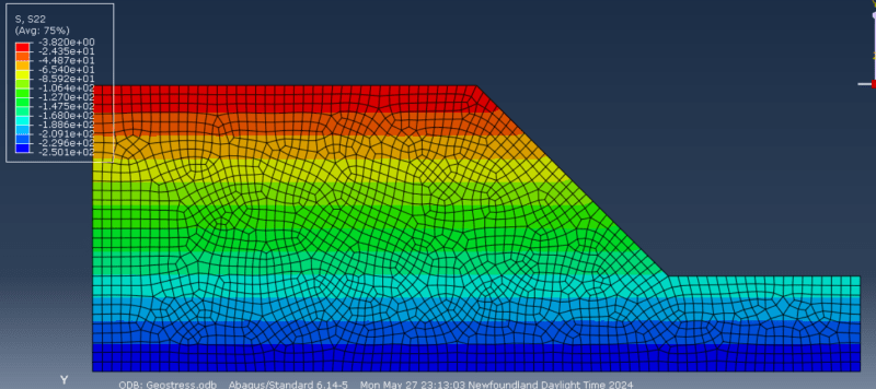

I want to model this slope in Geostress condition where I will expect this kind of result after end of the step. I can apply predefined field in the slope. I want to run this analysis in Dynamic Explicit Mode. But after running this analysis , I am not getting the expected result as this figure shown. Rather it shows the same stress at the bottom where I would expect less stress in right side because height is smaller than left side. Can you please guide me how can I overcome this type of problems?
I tried that one too. It shows the same stress in both side. But I would expect different stress according to theory.

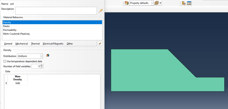

1. Here is my geometry and property. Left side is 15 m height and right side is 10 m.

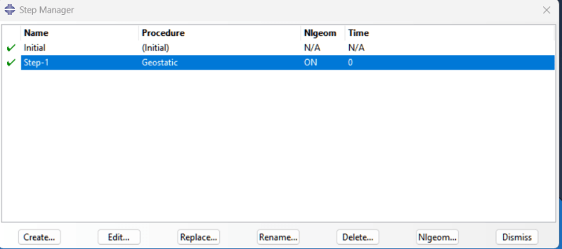

2. Here is the first step. I used the Geostatic Step.

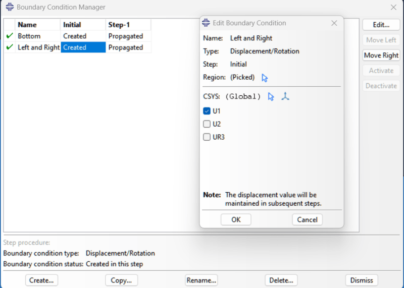

3. Here is the Boundary conditions. In my case, the bottom is restricted in an upward direction. The left and right sides are restricted by horizontal direction.

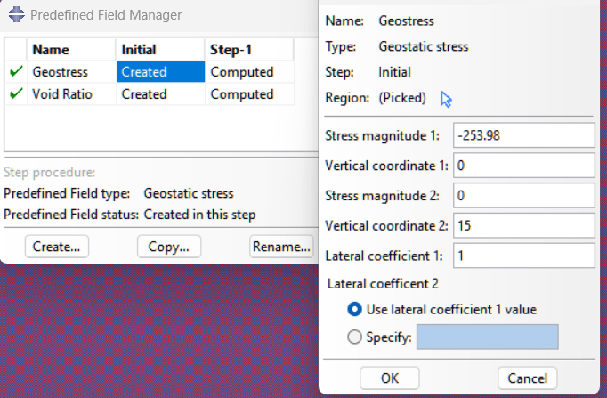

4. I used a predefined field to define the initial stress of the slope and the void ratio.
5. Here is the resulting photo where the stress is the same at the bottom when the time is equal to zero. And after finishing the geostatic step, it shows very different results, which is not acceptable according to theory.

Why don't you have a gravity load in this model ?

I can use gravity loading. But if I want to use different earth pressure coefficient then how can I do it? Is there any other way to define it?

Without gravity load, you won't have different stresses due to different heights so you should change that first.
