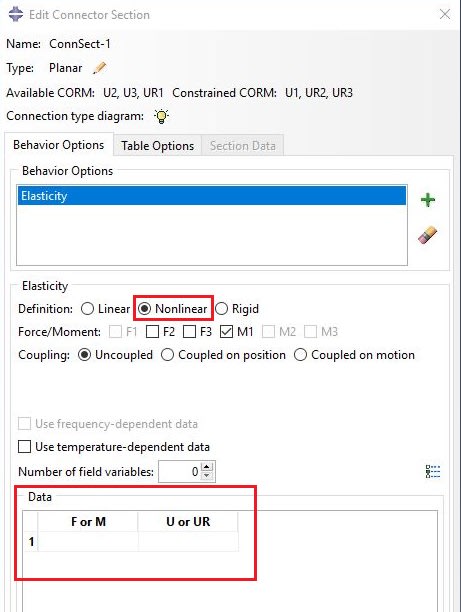

I am modeling a screw connection between the cold-formed steel beam and column flanges using discrete fasteners in Abaqus.
I am using a planner connection section. I am able to define a linear stiffness for the connector.
Now I want to improve the stiffness behavior and model a trilinear stiffness as depicted in the attached figure.

Could anyone advise, if this is possible in Abaqus and if yes, how to do that?

I forgot to mention in my earlier post that for a trilinear stiffness the coordinates of points 1,2 and 3 ( as shown in the attachment) are known to me.
When you add elasticity as a behavior for the connector section, you can switch from the default linear to nonlinear. Then you will be able to specify force-displacement (or moment-rotation) data points to define the whole curve.
Thanks for your response.
Just one question, when I switch nonlinear, and F2, F3 ( Available DOF in my case: I have attached a screenshot below), I get one Force/Moment Vs displacement/rotation response. Does that mean when I input values in the table the same stiffness will be applied for both F2 and F3?

If you want to define separate elastic characteristics for each direction, you can repeat the Elasticity behavior (add it more than once) and choose a different component for each definition.
That's great!... Thank you so much!
