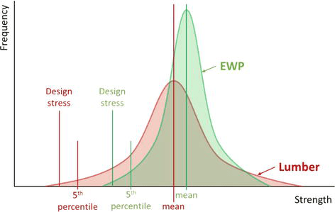

- Is the MOR a characteristic value (i.e. weakest 5% value)? This will need to be confirmed and I would be interested if you can post your answer from your research. Timber has a very flat normal curve which make characteristic values far lower than mean values. This is why sawn lumber has a far lower strength than LVL even though the average strengths may be similar (see the image below). For decking I would not be surprised if a mean value is used instead of a characteristic value.

MOR is on clear wood, so no defects. Not suitable for design. Also probably average not low end, so not suitable for design.
