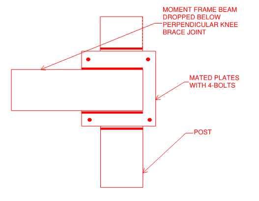

Yours is a clever solution and it's not as though you don't have a genuine load path. My concerns would be:
1) Difficult to find robust methods for designing the connections.
2) Tough to assess joint stiffness with confidence. I'd be concerned about that if this thing's holding up a heavy unit that might tend to flop over P-delta style if frame stiffness is lacking.
See the sketch below for another alternative to add to the heap-o-solutions if there's space. Inside of the verticals and just below the lower knee joint connection of the perpendicular frame. Bolts in shear should make for a pretty stiff connection that would be easy to evaluate.
