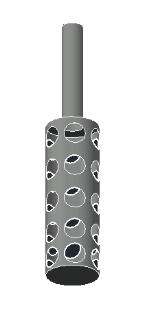

usually the blow-down pipe ends with a drilled short pipe, bigger diam then the discharge pipe (retired, just starting to learn how to draw in 3D : that's why I modified the sketch
