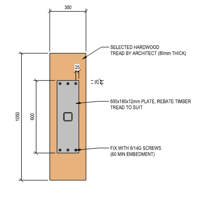

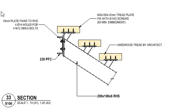

We've designed some similar stairs here, though not identical - a couple of snips below
Typical construction here is an RHS stringer then welded SHS stubs welded to a flat plate that solid timber treads are attached to
It creates a pretty hidden detail, it's nice
Typical RHS is 200x100 (8x4 in Americanese) - we don't have a 200x50 like you seem to (8x2)
One of the big concerns we've found is that a point load + balustrade moment load combination really fucks these things up
You get quite noticeable deflections and generate large tensions in your end fixings
In our case that's a cluster of 3 - but in your case that would only be 1 fixing as the angle wouldn't be wide enough for 2 or 3?

@Greenalleycat - Thanks for your example. Fortunately I have a pretty solid tread configuration with a flat plate that extends almost to the edge of the tread and a vertical fin on the front that stiffens it up. I have done treads in a similar way to your example before and had the same difficulty of getting the wood fasteners and flat plate bending to work.
