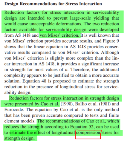

For the local stress combinations between longitudinal and transverse I tend to check Von Mises equation using serviceability loads to prevent large-scale yielding.
Using serviceability loads usually prevents this from governing the design.

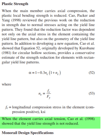

For ultimate strength you can ignore the interaction between longitudinal stress and local wheel stresses so long as the bottom flange is in tension. You can make use of Bo Dowswell's paper " Flange Bending in Single Curvature". See images below.
I don't think that means you can ignore the wheel stresses in combination with beam flexure, just that you don't need to reduce the capacity of the yield mechanism when the beam is in combined flexural and local loading. In any case, the member carries neither axial tension not compression, it is loaded in flexure.

Yes, the beam is loaded in flexure, however the bottom flange, which is where the interaction occurs, has tensile normal stress. I believe, the author is saying that the longitudinal tensile stress would have no impact on the yield line pattern from local wheel stresses in the transverse direction (for plastic design).
For strength design, you can check the local flange bending independently from the longitudinal flexural stresses (using an equivalent width approach)- as long as the bottom flange carries tension.

1. Transverse stresses and longitudinal stresses still have an interaction per von mises criterion. If this doesn't yield at service loads, the yield line mechanism should have lots of reserve capacity in the ultimate state, but they are still combined.
2. Under plastic strength - "When the main member carries axial compression'... talking about the beam, not the flange imo. "When the element carries axial tensions".. could be interpreted as you have. Either way, still need a combined check I believe, just without reduction of the yield line capacity. In any case, not yielding under service loads should govern.
I do agree that Von Mises criterion should be verified at the service load level for elastic stress distribution.
I have attached the article in case you do not have access to it - it is very useful.
The "reduction factor" referenced in the article is actually another way of expressing the interaction equation (The author also expresses the Von Mises equation as a reduction factor). The reduction factor is applied to the local flange strength as a way of encapsulating the interaction between transverse and longitudinal stress.
So when the author states that the yield line strength is not reduced when the element carries axial tension, I believe he means that the interaction is not critical (for plastic design, again).
My guess to the author using the term "axial compression" rather than longitudinal stress is to remain consistent with the original research he is referencing.
I can't think of any reason why a flange that is under flexural tension or compression would act any differently (or be more critical) than a flange under axial comp/tension when interacting with transverse stress.

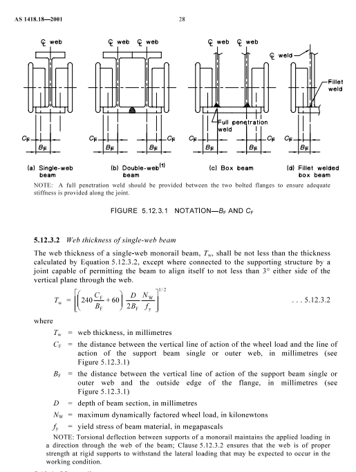

The AS code on cranes and monorails has an empirically derived formula that is essentially a canned solution for monorails it includes interaction effects. I think the BS also have something similar.
I find it all a bit black box of a calculation but it is pretty straightforward and conservative. If require I'm happy to post it here.
@human909
If you don't mind I would be interested in that equation.

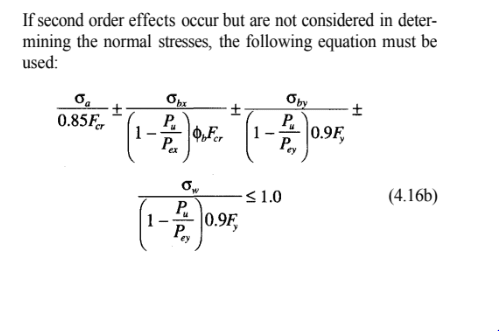

Already have the paper... getting side tracked on wheel loads though. If you read through S16 on singly symmetric sections in bending, it says to check LTB for each flange that experience compression along its length.
CDLD said:
We combine the stresses and ensure the top and bottom flange remain less than phi*FY (elastic).
So, you're combining the torsional warping stresses with the weak axis bending stresses compared to the yield. But, when you add in the strong axis bending stress you're comparing that only to the LTB limit? Then those two checks are just added together and compared to 1.0. Yeah, that sounds reasonable to me.
For the bottom flange (assuming it's always in tension), comparing it to yield seems reasonable as well.

As requested. From memory the commentary mentioned that the formula was based off empirical testing in the 70s. When I first began designing monorails I compared it to other international sources and calculations. In general it seemed conservative. Since my initial few designs I've largely accepted the 'black box' nature of it and churned out designs.
For what it is worth I used load factors of:
Hook and Sundary 1.2
Dynamic Factor 1.25
Total Factor 1.5
