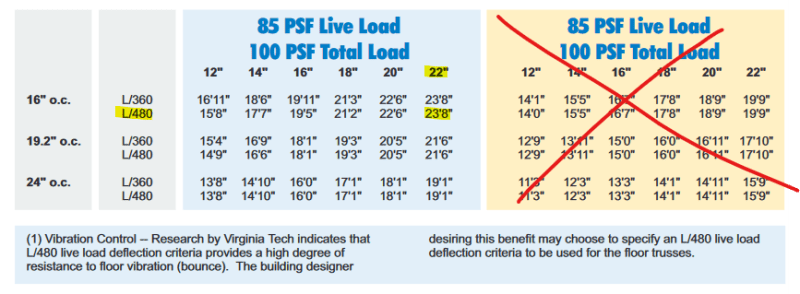

Take a look at a snip from a floor truss span table below. These are essentially SCL top and bottom chord trusses. They don't go to 100psf live load + 30psf dead load floor systems (130psf total load) - only 100psf total. Even at that, you have to get to 22" deep to span 23feet. You need to go 7 more feet and carry 30psf more. How you can accomplish this with anything less than a 30" deep wood floor truss?

I agree. I don't think this is the right type of construction for the type of building we are talking about. I think if we can add more columns and beams, have the trusses span 20', and install some sort of vinyl/engineered wood floor over the sheathing there's a chance it could work. But not with concrete exposed as they want.
