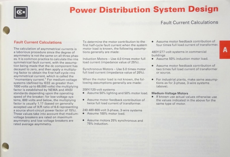

A page from a dated Cutler-Hammer Consulting Application Guide

It's a reasonable assumption for small motors if it includes motor feeder impedance. Typical value assumed for induction motors in ANSI is 16.7% but this doesn't include motor feeder. You can refer to the old IEEE Red Book and Buff Books for supporting documentation. Also keep in mind that any motors fed via adjustable frequency drives generally will not contribute fault current (non-regenerative drives) or contribute at a reduced level (regenerative drives).

IEEE C37.010:1999 assumptions and calculation methods work sufficiently well when considering large (>37 kW) machines, regardless of speed. They are more accurate when constrained to medium voltage symmetrical fault applications. In effect, the calculation methods uses a modifier that is applied to the subtransient (X'') reactance of the machine (along with other multipliers) to more accurately represent the momentary amplitudes found in the time period where circuit protection (e.g. high-speed breakers) operate. The net result of these modifiers is to bring the "effective" contribution down to something close to 4x rated nameplate current. This is usually lower than the actual maximum contribution for a fault at the machine terminals, but is adequate when considering the additional impedance of other network components that probably lie between the machine and the fault location.
IEEE C37.13:1990 and IEEE C37.41:2000 deal more specifically with low voltage applications (e.g. low voltage circuit breakers and both low- and medium-voltage fuses). Again, these use an "average estimate" of likely machine impedances as part of the calculation, based on the likely "mix" of equipment. Historically, the mix has been 75% induction to 25% synchronous, leading to a roughly (4x total nameplate current) approximation for short circuit purposes. This method is also suitable for mixes that have a larger induction percentage, because these loads tend to be larger in rating as well - thereby raising the "induction" portion of the total current even as the synchronous portion is reduced.
