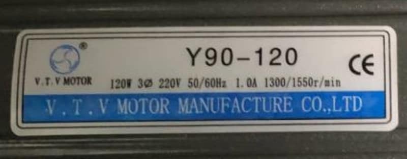

Here's one for serendipity, as we were talking in another thread about 120V 3Ø.
A guy called me yesterday to help him get and install a VFD to run a motor. I asked him to shoot me a picture of the motor nameplate. Check the voltages on it..
120V 3Ø??

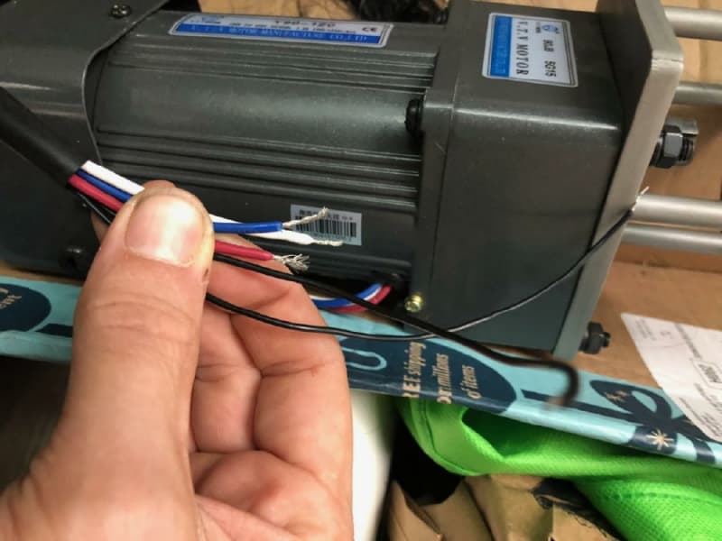

But wait! Look at the only wires it has:
Not sure what to make of this.. besides three un-rewireable power wires and two temp sensor wires.

I read that as 120 watts 3 phase 220 volts.
The CE marking is forged. I can tell by looking at it.
I know where that motor was built, even without looking at it.
OMG! I think you've cracked the mystery. I thought that was a 'V' but it may be a "W".
I was conjuring up all sorts of weird alternatives.
And yes the motors is a POS. It mounts vertically and has no thrust capability.

Those speeds are either a mistake or a whole lot of slip. The high slip probably explains the low efficiency.
Bill
"Why not the best?"
Jimmy Carter
Isn't 1550 rip'ems a common speed for (single phase) shaded pole motors?
This is a three phase induction motor. Normal speed for these is 1740 to 1760. That's 40 to 60 RPM slip.
This is showing 250 RPM slip.

Oh wow! That speed was not ringing any bells for me. That's it, horrid slip. Guy said 'they' came with a VFD that is impossible to work with and wants me to change it to something usable. All I know is that, "it ran a bunch of inter-digitated PTFE disks sliding across each other". That could explain the slip.
Now he wants to turn a paddle in water. I'll go visit the thing and maybe condemn it all for a niece little Ebay geared drive motor. I doubt dealing with that motor and adding some likely needed gear reduction would not be worth the bother.

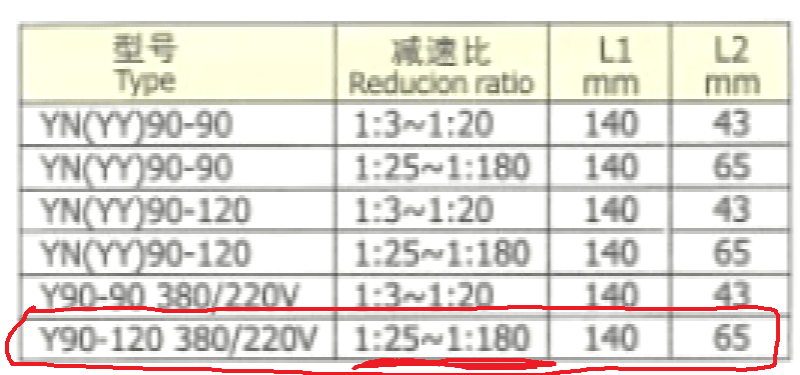

Dang Jeff! I just got back to report in. Once there low-and-behold the output shaft is offset from the motor center line so obviously a gear box. Hence the wacko speed difference - not crazy-slip after all.
That said, how does a 1:25~1:180 ratio get one from 1800rpm down to only 1550rpm? Wouldn't this infer 10 to 72 rpm? Ah if you follow down the gear box info it seems to be 75RPM output.
Great, the guy wants 200RPM.. sigh. I'm not going to try to spin that cheap bugger 4,000 rpm.
Thanks a bunch Jeff. I was hung up on name plate speed which would be the output speed around here. Guess not in China.

The nameplate shown in the photo is the nameplate of the motor. There is a separate nameplate for the gearbox.
And for such a small motor in IE1 1300/1550 1/min is fully reasonable. Look up a text book for "scaling laws" of electrical machines.
