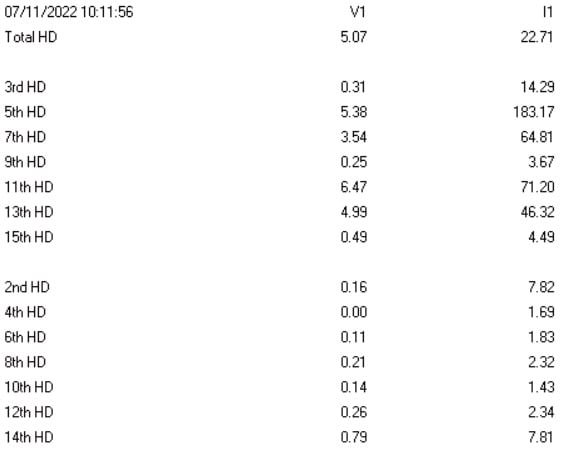

HI, we have a extruder, it has a motor 400HP with the Altivar 71 VFD.
THe original motor was burn and we rewind it, but it has overheating 100C, torque at 80% and the current is 400 amp, it is low beacause support 590 amp.
So that, we buy a new motor and it has the same issues...........
Sometime PTC is tripping.....
Could you help me?
Thany you for your advice.

However, we see the currect of the three wire is the same but a wire has 3 C degree more tha other wires.
Also, in the VFD inlet the voltage is 390 V and in the VFD I see 365 V, Could be the EMC filter of the VFD?
Have we got the harmonic issues?
Motor 400 HP 1500 RPM 50 Hz 400V S1
Would the temperature be for this motor if it works for 24hs?
Please, have you look at the attached below,

Gluzchuk: On the motor nameplate should be either an "Insulation", "Insulation Class", or "Rise" field. Hot hot the motor windings are expected to get is dependent on what these values are. And, as LittleInch indicated, the "Ambient" value plays into the answer as well.
A typical extruder application has a somewhat parabolic power-to-speed relationship (not quite a square-law and not quite a cubic, but somewhere in between). What this means is that the motor draws more current (to produce more power) as the speed increases. Load is also going to be proportional to the density of the medium being extruded - if your process has been modified to a different material, the power/speed relationship is different.
The original process equipment seems to be 2011 vintage (you indicate in your 9 Nov post that the motor has been in operation since 2011). This means it predates the IEEE 519-2014 edition - but I'm going to bet that the drive you are presently using does not. If that is the case - the TOTAL VOLTAGE HARMONIC (THD) limit is 5%, with no single harmonic (up to 151th) over 3%. Depending on the number of the current harmonic (3rd, 5th, 11th, 21st, etc.) the maximum allowable limit changes with the Isc/Iload (short-circuit current to load current) ratio; for the frequencies you're likely to be seeing, no single harmonic exceeds 12% and the TOTAL CURRENT HARMONIC (TDD) is likely to be less than 15%. From the data you provided, you're well outside this condition.
Having high harmonics can definitely lead to thermal stress in the windings. So can operating above the design power level for the speed (in part because the machine can have a difficult time properly cooling itself at slower shaft speeds). That is why a lot of variable speed motors use separately-powered fans for cooling, instead of shaft mounted fans (like a "standard" TEFC or TEAO construction.
You also mentioned seeing a temperature of 100 C - was this a TOTAL temperature, a RISE temperature, or something else? How was it measured, and on what part of the machine? PTC sensors are "on/off" devices - they can only tell you when you've passed a preset limit going in one direction or the other, not where you are below (or above) that limit).

@Gluzchuk (Industrial),
My own calculations based on the harmonics data you provided tell me your motor can not take more than 60% of your motor capacity without overheating. The factor K I got is 1.678 and you have to reduce the motor load to 1/K ~ 60%. Perhaps, the rewinding job made the new motor impedance reinforce the harmonics from your VFD and made it larger, IMO.
Better still, use detuned filters to trap the harmonics. Choose a tuning order of 4.7 (your major harmonics is the 5th).
The harmonics table provided by the OP looks like the typical spectrum on the input line. So, there is no justification to calculate the motor derating by this as done by Parchie.
If the VFD is misfiring, it can be detected either with electric or vibration instrumentation.
Fluke's instructions for troubleshooting a VFD are here (electrical instrumentation)
Vibration Analysis Case Study 3 – Variable Frequency Drive Deterioration(vibration analysis).
Misfiring will often show up as torsional vibration (or coging at low speed).
These approaches will also detect a number of hard to troubleshoot motor defects.
