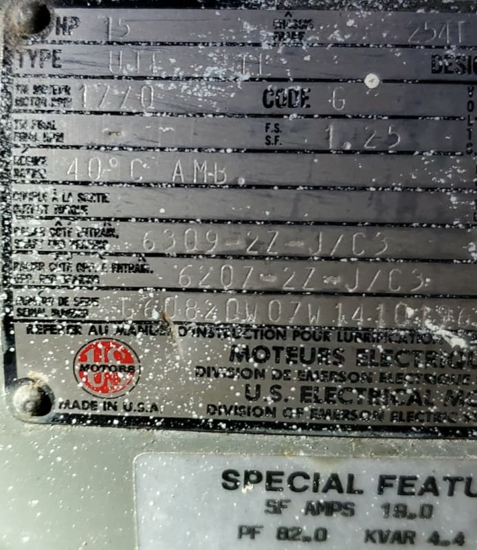

I've got a 15HP 575V motor that's lost it's country finding itself wandering in 460V land.
I want to replace it with a 460V unit.
I see that it's a Chassis/Frame 254T.
I'm not all that clued-in to exactly what 254T relates to in detail.
What else should I be watching out for?

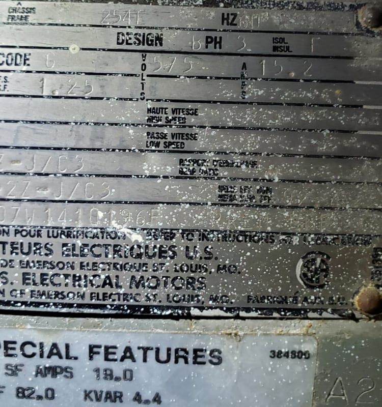

itsmoked: Other than geometry, there are a few rating things you need to watch for as well.
1) Note the KVA code (G): this means inrush is supposed to be limited to something between 5.6and 6.3x rated current. More importantly, that translates to an actual AMP range (85-96 A). You might need to verify the replacement 460 design also meets that maximum current limitation (which should mean a lower allowed "per unit" inrush, since the 460 design will draw more current at rated condition).
2) Also note that the 575 nameplate gives a 1.25 SF - this means it could run at 25% above nameplate (or roughly 19 HP) continuously: if the process still requires this capability, make sure the replacement machine is capable of it.
3) In a similar vein, if the process is actually speed-dependent, verify the running speed of the new design. Chances are you'll be close to the listed 1770 of the original ... but it pays to check before you get to the "fire it up" stage.
4) Lastly - check the power factor of the replacement machine. Your PF correction might not be correct for the 460 design if it's much different than the listed 0.82 PU.

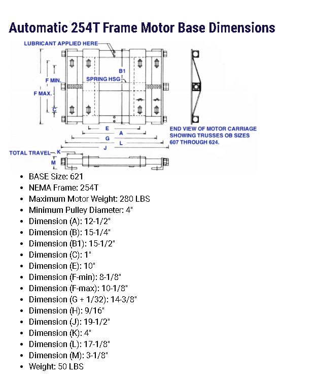

5) NEMA (and IEC, come to think of it) both use "standard" frame sizes in the smaller power ranges: 254T is one such for NEMA. In general, this standardization governs the exterior geometry of the design (shaft height, foot bolt location, length between bearing centers, overall height/width, shaft extension diameter and usable length, shaft key geometry, and distance from end-of-shaft to first hold-down bolt). It does not necessarily limit you to foot- or face-mount designs ... there's usually something buried in the manufacturer's "smart" model number that tells you which it is (if you can't physically see the thing for yourself).

Thanks much Red, Gr8blu, and Bill!
Your responses were very helpful. Bill you have me reconsidering.. I can buy 2 transformers for less than an Ebay motor with a questionable pedigree and this would bypass all the motor gotchas too.
Thought I responded yesterday! Since I didn't I'll add that I did go with the open delta. I went to my favorite site and was greeted with every last "lighting" transformer being out-of-stock except they had two 3kVA units.
That is some serious omenage so I proceeded down that path.

On an open delta, the secondary windings have to carry the motor rated current. It is a single connection, not a combination of two phases as a full delta,so there is no worry about phase angles or the resultant of currents at two different phase angles.
Current in equals current out equals motor phase current.
For a 120 Volt secondary, (480V + 120V = 600V) the rated transformer current at 3000 VA = 25 Amps.
Service factor Amps = 19 Amps.
19 Amps x 1.25 (code) = 23.75 Amps capacity required. Good to go.
We used to hook them up directly to the motor and tweak the overload relay for the current at the supply voltage.
For future sizing, when stepping down with an open delta auto-transformer, the secondary carries the motor current plus the transformer primary current. It adds a step or two to the arithmetic but it is still a simple calculation.
