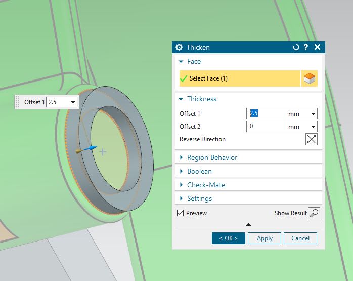

Is it possible to move a face without the tangent rounded corners moving with it?
I am working with the machined faces on a casting.
I have always worked with extrusions to remove the stock but in this situation, it is difficult to do.
I am on NX1899
Jerry J.
UGV5-NX1899
Is the intent to add stock to the casting for machining later?
when Move face doesn't work like I want it to, I'll extract the face and then thicken, remove the hole, and unite it.
My intent is to remove the material from the casting.
It would be very nice if we could just move (or offset) the face (without extruding) and not move the rounded corners and fillets.

Jerry,
Can you add a picture to that question ?
Regards, Tomas
The more you know about a subject, the more you know how little you know about that subject.
Yes, I tried pulling the face and I got the same result.
