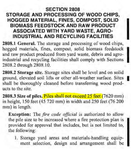

I'm not finding the reading material I'm looking for online so I was hoping someone here could shed some light on a situation. During a grubbing project completed January 2023, mulch piles were kept below the maximum height (~50') and the advised Length and Width(I forget these dimensions). What would cause this mulch pile to (seemingly) spontaneously ignite 10 months later? Is that not very surprising to someone more knowledgeable on the subject?

50 feet is way too high and it should have been expected.
Compost and mulch piles can reach internal temperatures in excess of 150 degrees F. Besides, it naturally produces methane, which is slightly flammable. Facilities that handle these have to turn the material over on a regular basis.
This New York guide says 25' max.
Another site noted NFPA may allow up to 60', but IFC max is 25'.
Thanks CarlB. I was looking for a code to reference.
As far as the pile igniting 10 months later, it sounds like we need to turn over and manipulate the pile at some frequency. Thanks for the recommendation TigerGuy.
