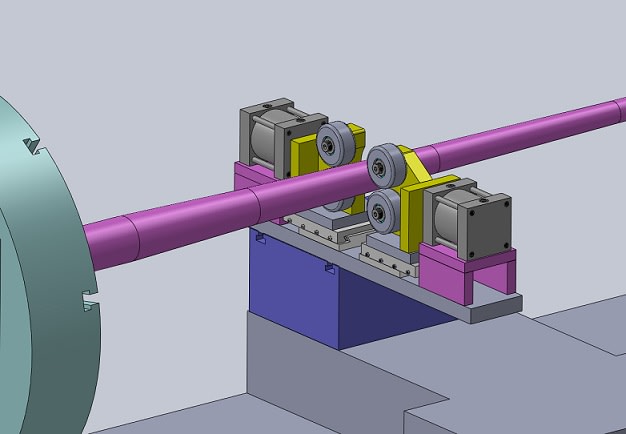

I've been tasked with designing a system using three air cylinders working together simultaneously. They will be 4" double action cylinders, 1" rods with 2" travel arranged 120 deg apart arriving at a center (circular) focus at the same time and applying the same force and then return. I'm starting from scratch here. It embarrasses me that I know almost nothing about these kinds of systems. I know I'll need pressure regulators, manual switches, hoses, manifolds and maybe solenoids etc. I want to be able to buy materials off the shelf when I can or otherwise make it here in the shop. Can anyone help me here?

OK Here's an update. I hope I still have everyone's attention. I've redesigned the setup using only two air cylinders which will be installed “nose to nose” opposing, with metal forming going on in between using rollers while it spins. To be clear, the idea is to spin-form an aluminum tube over a mandrel into a taper as the rollers under force travel down the length of it on a lathe. The total stroke length will be less than 1–1/2″ from two 4″ cylinders with 1″ dia rods. They need to arrive at the target very close to the same time and exert equal force. Because we're spinning the taper over a mandrel it has to be done in short length increments as well a diametrical, feeding the tube out onto the mandrel little by little with final full length sweeps as it nears the final shape. I’ve done this manually before using three rollers driven by a cam system and a hand lever. This tube is much bigger and thicker. Here's the idea. I would very much like your thoughts. Would electric linear actuators be better or would that be a similar problem?
Electric actuators will need force balancing, which is possible if the motors are fed from a common supply...I think.
But your pneumatic cylinders, if fed from a common plenum, will tend to be automatically force balanced, i.e. have equalized pressure on the driving side of the cylinder, as the flow will automatically balance cylinder pressure when one cylinder makes contact and the force to cause further motion increases.
Thanks, btrueblood. In this case the "plenum" would be the shop's common air compressor tank which delivers about 120 psi going into two 4" pneumatic cylinders should yield something over 1500 lbs force each....all things being equal, which seems to be the question. Unless advised otherwise again (I'm hoping for more advice), I'll need a manifold for splitting the compressed air path and cylinder return exhaust and a regulator to control the pressure and filter the in-going air etc and an activation switch of course. This is all new to me. It needs to get done though. I wouldn't be asking if I was sure.
" I'll need a manifold for splitting the compressed air path"
Right. And it wouldn't hurt to oversize this manifold, i.e. make the i.d. a size or two larger than the lines from it to the cylinders, so that the pressure has a chance to better equalize b/n both drive sides.
I'm assuming there are radial supports for the reduced rod somewhere off to the right in your picture? If not, then you may want to think about adding them, or have a secondary drive that holds the effective center of the reduction within some small distance of the center of rotation of the chuck or whatever that is on the left.
Yes. What's going on to the right is a steady-rest (when needed) and an a live center at the very tip. I've done this before with a manual/mechanical set-up using a rotary cam plate and a long hand lever and it worked. This is just bigger, longer and meaner requiring more force. Thicker wall tube. It's done incrementally with graduating lengths and diameters feeding the tube little by little on to the mandrel which never changes position. The cylinder ports are 1/2 NPT.
