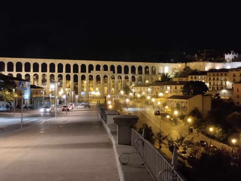

Took these pics in Nov, ... after 1950 some years.
They have installed some tension rods though. Maybe they were a bit short on lime.

that is in spain yes ? I was at pont du gard some years back (had my car broken into, in Arles !)
It happens. But you will probably not get hurt. Segovia is small and pretty safe. They have a huge parking garage with controlled access. Barcelona is the worst place these days.
I have not been to Arles. I wouldn't mind having a a visit there.

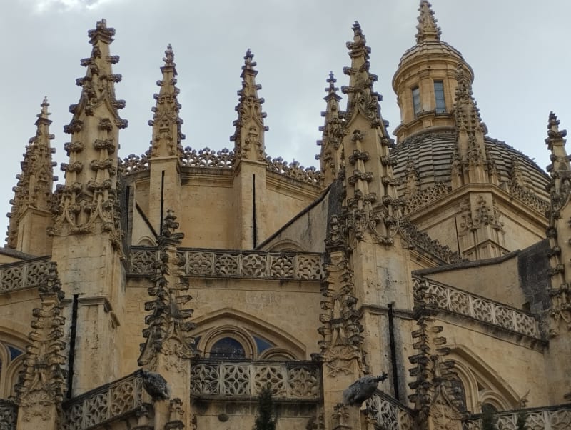

The medieval cathedral builders had the same problem with tension and they didn't even have Roman concrete. The flying buttresses were all about providing lateral bracing to the main structure with arches, using the little pinicles to supply extra weight where needed to keep the arches entirely within the compressive stress zone.
The cathedral in Sevilla is the worlds largest Gothic style church and has some really impressive flying buttresses.

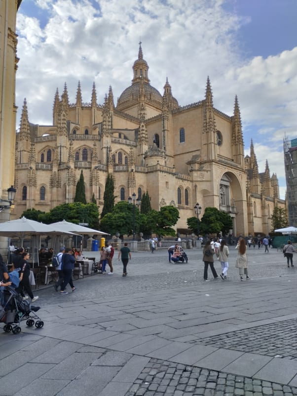

I found Segovia's cathedral. Buttresses from inner column line to the outer wall.
As long as I've already turned this thread into a travel blog...
Arches in the largest church in the world in nearby Cordoba, previously a mosque, while not having flying buttresses, are none the less impressive. Originally 720 columns. If you are ever in Spain, don't miss this. I'd rather see this one again than go to St. Paul's, Vatican City. I think I am due for another visit soon.
