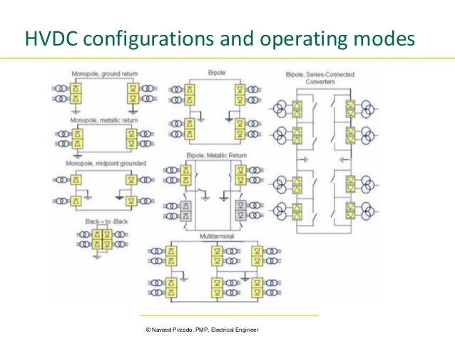

We are investigating if an HVDC - Symmetrical Monopole VSC can meet the N-1reliability criterion. The concern is triggered by the issue that a fault on any of the (+) or (-) DC poles will get the system totally out. Similarly, a single AC output from the converter station does not have redundancy in case of any fault.
Any thought will be helpful
The one I’m semi familiar with runs each pole independently. One side can trip and the other remain in service. When one pole trips it relies on ground return.
At a difference of a bipolar configuration, a monopolar arrangement, including the symmetrical monopole one, does not have redundancy and a fault on any of the HVDC poles will shoot down entirely the system as indicated in the enclosed article.
There are several planned offshore wind power project on the East coast as large as 1,200 MW. Many of those projects are planning stages intended to replace retiring fossil generating plants that generally meet the N-1 and reliability redundancy planning criteria. However, I had a hard time harmonizing the use of a large HVDC symmetrical monopole considering potential vulnerability for a single point of failure.
We anticipate major challenges for power engineers in the next decade in the USA with the large penetration of renewable generation. One of the concerns of getting approval for organizations such as NERC, NPCC, and NYSRC. Noted that conventional generating plants can trip individual generators and HVDC tripping suddenly 1,200 MW somehow could disturb any bulk power system including subsynchronous resonance, potential system stability, among other issues.
[highlight #FCE94F]Any thought regarding potential single point of failure for symmetrical monopole application will appreciate it[/highlight]

The Symmetrical Monopole VSC is supposed to have a mode where it can continue to operate (with no derating) with one leg temporarily shorted to ground as might occur during a lightning strike when the MOV operates. Longer events with one leg earthed require the link to be taken off line as the insulation requirements on the unearthed pole double. My opinion is that this impacts the likelyhood or time between link outage (statistical measure), but by itself this feature can not change the impact of a link outage. Ability to meet N-1 or N-1-1 is then a feature of the system(s) the link is connected to.

Is this specifically for NERC TPL defined contingencies? I had assumed a symmetrical monopole system would be treated the same as an AC line of the comparable capacity for TPL studies. If the cables or converters have significant lead-times to repair, it could certainly make sense to model an extended outage. There are a number of conventional power plants with multiple generators rated more than 1000 MW each, so loosing a single DC cable to a 1200 MW wind farm seems not unreasonable to me.
Other than the duration of the outage, I don't see how loss of the DC cable to the wind farm differs from a loss of wind. If planning allows for windless days, loss of the cable is already covered reliability wise. Of course NERC and reliability don't always align.

It is recognized that windmills have daily and seasonal generation variability but the range window is typically several hours. The operator is getting better at forecasting the power to be dispatched from wind and other generation resources for a daily power cycle.
DC cable outages do not happen often, but went it does the repair time is fairly long for several days. The data below despite an indicative time estimated from various sources for illustration purposes. There is a major consequence because of long outages, impact on the system performance, overstresses, overvoltage, lack of revenue, cost of repair, operational confidence, etc.
To assess the system risk a typical repair time for a submarine cable is several days and the longer registered repair time was around 85 days. An average indicative time is as follow:
1) Specialized ship to reach fault position:........3-5 days.
2) Cable splice...............................................1/2-1 day
3) Unforeseen* conditions.............................. Unknown (Estimated for several days).
*NOTE: (bad weather, mobilization, delays & operational difficulties)
A typical repair time of an AC line is a lot smaller and almost all OH lines have the reclosing capability with a high success rate for SLG fault.
A force long unplanned outage of a week or so appears to be a long time even for an intermittent power source such as an offshore wind generation.

The thing I found most interesting was how they handle the loss of one of a pair on lines -- they use the Pacific Ocean as the return. You can see this neutral return line on transmission towers leading away from the facility towards the ocean.
Hi cwilson,
Thanks for letting us know about your experience with the ±500 Pacific DC Intertie (PDCI). The PDCI may no be the best example to compare the VSC since this is a long overhead link with a bipolar configuration with ground return using the classical HVDC current source converter (CSC) technology with a ground return providing redundancy to operate at 50% capacity in the event of a fault in any of the positive or negative pole until the fault is repaired.
To pass the economic test with very expensive submarine cable, most of the new offshore wind generation (OSWG) projects prefers using a voltage source converter (VSC) technology because of many operation advantages over the LCC (see note below). The vast majority of new OSWG projects are developed using symmetrical monopole using XLPE cable currently up to ±320 kV bundle submarine cable without ground return.
For a system operating without redundancy in the event of long lead repair time between failure appears to be a disadvantage for this technology and difficult to meet the required system reliability.
VSC Fault Scenario: for a single pole-to-ground fault for the ungrounded VSC symmetrical monopole configuration.
1) The dc line is cleared by the ac circuit breakers at the VSC converters at each end of the two-terminal transmission.
2) Power flows and pole-to-pole voltage stays the same, during the fault.
3) Overvoltage of 2PU on of the un-faulted pole apply excessive stress to a cable
4) No surge of fault current flows through the VSC converters.
