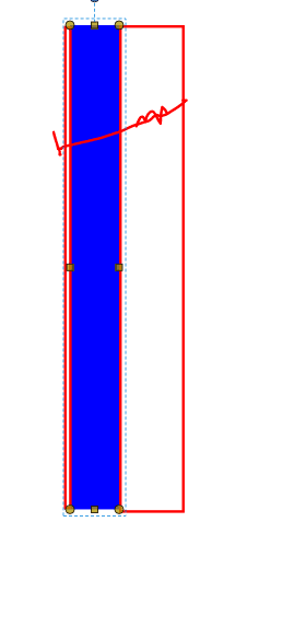

I discussed this recently with a friend who was facing the same problem:
a) He never did find anything definitive in the literature etc.
b) The issue was really the gravity load.
c) He decided to use some diagonal screws to to set up a strut and tie mechanism with the foam as the struts. I don't remember if this was for all of the fasteners or just intermittent ones.
d) I really have no idea how one manages to hit the studs accurately when coming through the insulation.
Can't these panels be self-supporting for gravity load (like brick veneer), and then you just need nails or screws for wind suction, like phamENG said?
